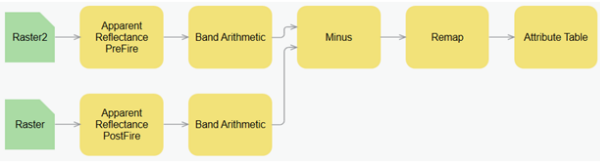

RFT example
The RFT below demonstrates a methodology for describing burn severity and the health of vegetation recovery using prefire and postfire imagery.
RFT example
This example RFT is composed of the following raster functions:
  • Apparent Reflectance—Express the input imagery as albedo, which is the percentage of the available energy reflected by the planetary surface. It is commonly used by scientific users for complex modeling and technical remote sensing applications.
  • Band Arithmetic—Perform a normalized burn ratio (NBR) index for prefire and postfire data from the output of albedo data.
  • Minus—Create the change (or delta) in the NBR from the prefire NBR and postfire NBR.
  • Remap—Define class break values for severity and vegetation health from the difference of the NBR.
  • Attribute Table—Assign attributes and colors to the integer values created from each class defined in the Remap function.
