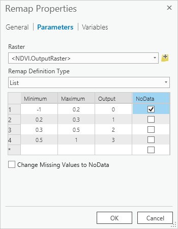

  3. Right-click the Remap function and click Properties. On the Parameters tab, enter the values in the following screen shot into the table, and click OK.
    Remap table
    These values are specific to the image you are analyzing and may need to be adjusted to extract vegetation from the image you are using.

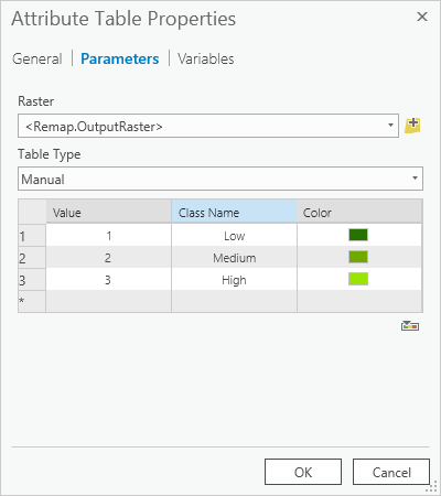

  4. Right-click the Attribute Table function and click Properties. On the Parameters tab, change Table Type to Manual and enter the values in the following screen shot into the table, and click OK.
    Attribute Table properties

  7. Right-click the Remap function and click Properties.
    1. On the Parameters tab, change the Minimum and Maximum values for the rows to adjust the values that represent low, medium, and high vegetation.
      Keep in mind that the maximum value is exclusive, so the minimum value for the next row should be the same as the maximum value for the previous row. This ensures values are not lost when reclassifying.
    2. Click OK.
