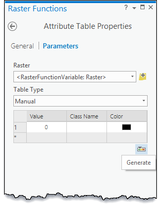

Add an attribute table manually
To manually add an attribute table, complete the following steps:
  1. Go to the Attribute Table Properties pane and click the Parameters tab.
  2. For the Table Type parameter, choose Manual.
    Attribute Table function parameters
  3. Click the Generate button.
  4. In the Generate pane, set the values for Minimum Value and Maximum Value.
    The current range of values to choose from is between -127 and 127.
  5. Optionally, provide a base name for the classes associated with each unique value, and set the color scheme and the transparency.
  6. When you're finished, click OK.
  7. To further refine colors, in the Attribute Table Properties pane, on the Parameters tab, click the item in the color column and choose a color.
