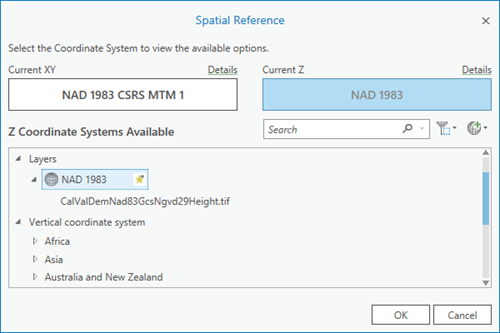

  4. If you want to change the coordinate system, click the Coordinate System button to open the Spatial Reference dialog box.
    The Coordinate System field is automatically populated with the coordinate system of the source raster layer that is being exported. If a vertical coordinate system is associated with the source raster, it will be displayed as an option for selection.
    Export Raster Spatial Reference dialog box
    The Spatial Reference dialog box is contextual and will list either an xy- or a z-coordinate system depending on whether you select the Current XY or Current Z coordinate system option.
    1. Select a spatial reference system and click OK.
    2. Select the appropriate Geographic Transformation when your data is transformed between different coordinate systems.
      The application will only use those transformations appropriate to the projection, all others will be ignored.
