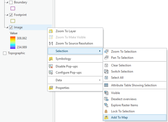

You can also make a selection within ArcGIS Pro, add the selected slices as layers of the map, then you have access to these layers for use within your geoprocessing tools. When you make a selection and add it to your map, you can also choose multiple images to add to map.
Add selection to map

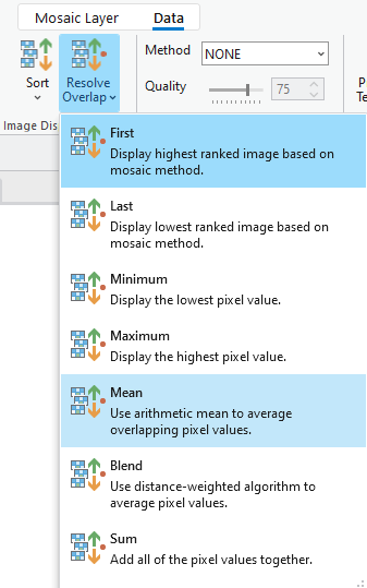

If you are trying to calculate the minimum, maximum, or mean from a set of data slices, make the appropriate definition query, then set the mosaic dataset's mosaic operator to be Minimum, Maximum, or Mean. Now you can export the output using the Copy Raster tool.
Resolve overlap = Mean

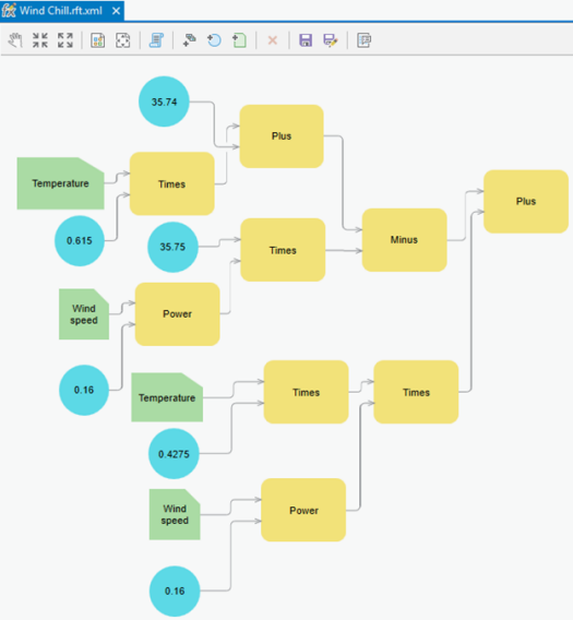

A scientific formula can be represented in a raster function template. For example, a wind chill index can be calculated from temperature and wind speed.
wind chill = 35.74 + 0.615T - 35.75*(V^0.16) + 0.4275T*(V^0.16)
This equation can be represented as a raster function template. ArcGIS Pro provides the Wind Chill raster function in the Raster Functions pane. Optionally, it can be added through Raster Function Editor.
Wind chill model

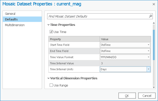

Multidimensional image services support a WMS's time and vertical dimension queries. If you intend to publish an image service that supports standard WMS time and elevation queries, set the fields used for time and vertical dimensions in the mosaic dataset properties before publishing the multidimensional mosaic dataset.
Use Time
