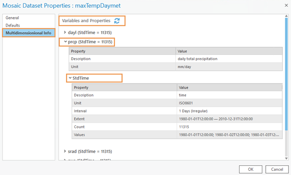

View multidimensional properties
When a multidimensional mosaic dataset is created from netCDF, HDF, or GRIB files using the workflow above, the variable and dimension information is imported into the mosaic dataset. The information is available in the Multidimensional Info tab in the Mosaic Dataset Properties pane. Each variable is listed separately, with subtabs containing information about the dimensions associated with the variable.
View the multidimensional raster precipitation variable and the time dimension information from the Multidimensional Info tab in the Mosaic Dataset Properties window
The Multidimensional Info tab is also available under the Source tab in the mosaic dataset Layer Properties.
