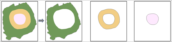

    • CONTOUR_POLYGON—Nonoverlapping polygons between 0-250, 250-500, and 500-575 (Fig. 1)
      Polygons between 0-250, 250-500, and 500-575
      Figure 1. The Contour polygon option creates three nonoverlapping polygons between 0-250, 250-500, and 500-575.

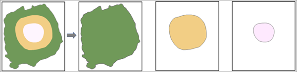

    • CONTOUR_SHELL—Overlapping polygons between 0-575, 0-500, and 0-250 (Fig. 2)
      Polygons between 0-575, 0-500, and 0-250
      Figure 2. The Contour shell option creates three overlapping polygons between 0-575, 0-500, and 0-250.

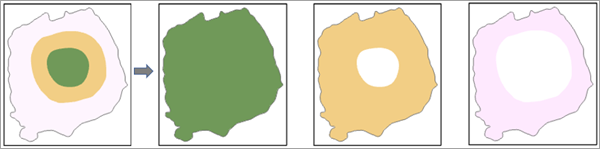

    • CONTOUR_SHELL_UP—Overlapping polygons between 0-575, 250-575, and 500-575 (Fig. 3)
      Polygons between 0-575, 250-575, and 500-575
      Figure 3. The Contour shell up option creates three overlapping polygons between 0-575, 250-575, and 500-575.
