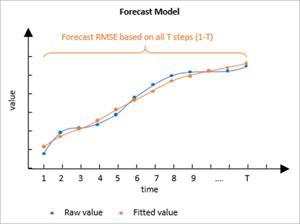

Forecast model
The forecast model is constructed by fitting the chosen curve type to the time series values at each location of the space-time cube. This curve is then extrapolated into the future to predict the values of future time slices. The fit of the curve to each time series is measured by the Forecast RMSE, which is equal to the square root of the average squared difference between the curve and the values of the time series.
\[ \mathrm{Forecast RMSE} = \sqrt{\frac{\sum_{t=1}^{T} (c_t - r_t)^2}{T}} \]
where T is the number of time steps, ct is the value of the curve, and rt is the raw value of the time series at time t.
The following image shows the raw values of a time series along with a Gompertz curve fitted to the time series. The Forecast RMSE measures how much these two time series differ from each other.
Forecast model for Curve Fit Forecast
The forecast model is fitted to all time steps.
The Forecast RMSE only measures how well the curve fits the raw time series values. It does not measure how well the forecast model actually forecasts future values. It is common for a curve to fit a time series closely but not provide accurate forecasts when extrapolated. This problem is addressed by the validation model.

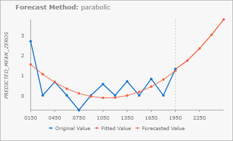

Pop-up charts
Clicking any feature on the map using the Explore navigation tool displays a chart in the Pop-up pane showing the values of the space-time cube along with the fitted curve and the forecasted values. The values of the space-time cube are displayed in blue and are connected by a blue line. The fitted values are displayed in orange and are connected by a dashed orange line representing the curve. The forecasted values are displayed in orange and are connected by a solid orange line representing the extrapolation and forecasting of the curve. You can hover over any point in the chart to see the date and value of the point. Additionally, if you chose to detect outliers in time series, any outliers are displayed as large purple dots.
Time series pop-up
The pop-up chart displays the original values, fitted values, and forecasted values.
