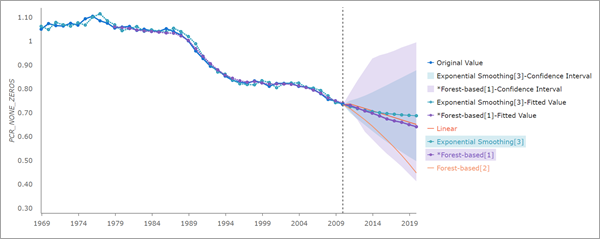

You can click any other method in the legend to display its fitted values and confidence interval (if supported). The following image shows the same chart after clicking the exponential smoothing method:
Pop-up chart of two forecast methods
The pop-up chart displays the confidence intervals of two forecast methods.

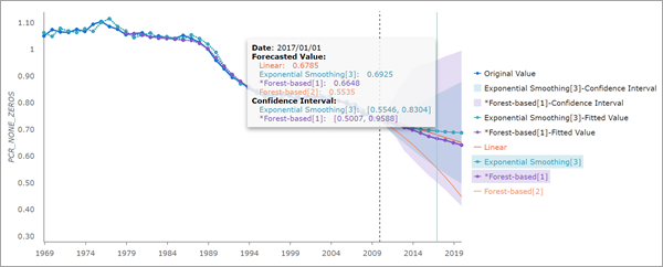

Hovering over the pop-up creates an interactive time slider (vertical cyan line) that displays all values of the chart at that time step:
Time slider displaying all values of the chart
The time slider displays all values of the chart at that time step.
