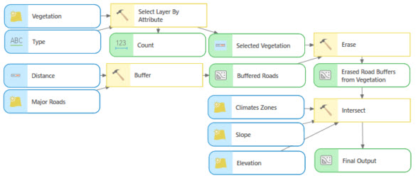

Example
This geoprocessing model is used by a conservation organization to identify potential habitats for an indigenous bird species based on vegetation type, distance from major roads, climate, slope, and elevation.
The model runs the following tools in sequence:
Select Layer By Attribute—Select the correct vegetation type from a Vegetation map layer.
Buffer—Create areas within a distance of 1,500 feet around major roads.
Erase—Erase the buffer areas from the selected vegetation areas.
Intersect—Overlay the output of the Erase tool with other map layers, including slope, elevation, and climate. This identifies the areas that meet all criteria.
