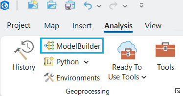

Open ModelBuilder
On the Analysis tab, in the Geoprocessing group, click ModelBuilder to open it.
ModelBuilder button
A new blank model is opened. The model is created in the project's default toolbox. You can resize, dock, or tile the model view in any position, as you would a map.

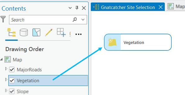

Add data
Models work with data, with the output of one geoprocessing tool used as input to another tool. You can start building a model by first adding the data you want to process.
To add data to a model, drag layers from the map Contents pane and datasets from the Project pane into the model.
The layers and datasets are added to the model and display as input data variables.
Adding a layer to a model

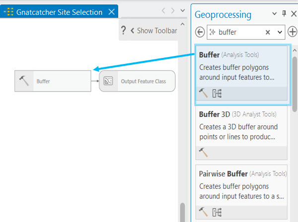

Add geoprocessing tools
Geoprocessing tools are a fundamental part of a model. ArcGIS Pro has many geoprocessing tools for accomplishing an extensive number of GIS tasks. Once you know the right tools for the work you are doing, it is straightforward to add those tools to a model.
To add a geoprocessing tool to a model, ensure that the model view is active; then, start typing to search for a tool. A list of search results displays on the Add Tools To Model dialog box. Double-click a tool to add it to the model. Alternatively, you can drag a geoprocessing tool into the model from the Geoprocessing pane or Catalog pane.
The tool is added to the model and typically appears as a gray rectangle, indicating that the tool is not yet ready to run. In addition to the tool, any output data variables that will be created by the tool also appear in the model diagram.
Adding a geoprocessing tool to a model

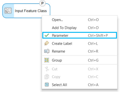

Set model parameters
You can make any variable into a model parameter. Variables that are set as model parameters show as tool parameters when the model is run as a geoprocessing tool, allowing you to specify different data or values for a model to process than what was specified when the model was created.
To set model parameters, right-click any variable in the model, and select Parameter to make the variable a model parameter.
An indicator (P) is displayed above the variable to indicate it is a model parameter, and a check mark appears next to the Parameter option in the variable context menu.
Making a variable into a model parameter

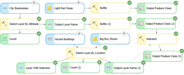

Run the model
Click the Run button on the ModelBuilder tab to run the entire model.
While the tools in the model are running, a progress window appears that indicates which tool is running and any messages. As a model is running, the actively running tool is highlighted with a progress bar.
A tool that is run successfully shows a Check Mark icon , and a successful output also shows a Check Mark icon . Any output variables that are marked Add To Display are added to the last active map.
Entire model has been run.
All tools in the model have finished successfully.
