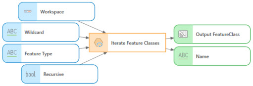

Double-click the iterator element to view and change its settings. A commonly used iterator, Iterate Feature Classes, is shown and explained below.
Element
Description
Workspace
Input workspace (such as a geodatabase) or a feature dataset.
Wildcard
Combination of * and characters that help to limit the results. For example, A* means that only feature classes starting with A are included. This is optional.
Feature Type
A feature type filter that helps limit the results. The most common are Point, Line, and Polygon. This is optional.
Recursive
Determines whether the iterator will go into subfolders in the workspace. This is optional.
Output Feature Class
Output variable that contains the path of the feature class. This variable can be used as input to all geoprocessing tools that accept feature layers or feature classes.
Name
Output variable that contains the name of the feature class. This is a string.
The Iterate Feature Classes tool requires an Input Workspace value (the variable named Workspace in the graphic above) where all the feature classes to iterate through are stored. Three additional settings, Wildcard, Feature Type, and Recursive, are used to restrict which feature classes in the workspace are iterated and control the iteration in subfolders in the workspace.
The Iterate Feature Classes tool has two output variables: a feature class and the name of the feature class. The feature class variable can be connected to the next tool for processing, and the Name variable can be used for inline variable substitution.
