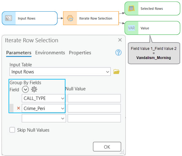

  • More than one group by field can be used for the selection. If one or more group by fields are specified, the number of iterations is determined by the number of unique combinations of the group by fields. For each iteration, the selection of the output feature layer is determined by the number of records that match the given combination of the group by fields. If more than one group by field is specified, the values are concatenated <field value1>_<field value2> in the output inline variable name. In the example below, two group fields, CALL_TYPE and Crime_Peri (crime period), are used. The output value is Vandalism_Morning, and so on for the other values.
