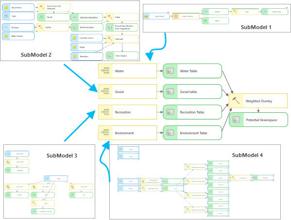

Large model
An example of a large model that could be broken into four submodels and one main model that runs the four submodels.
The large model above could be broken into four submodels and one main model. The smaller submodels can be added to the main model and connected to a final process. When a submodel is added to another model, the submodel's output parameters will be added as output variables.
Adding submodels to main model

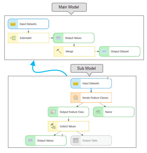

The example below is a workflow that merges a set of inputs from a geodatabase. The Merge tool accepts multiple feature classes as input to merge, but there is no automatic way to add all feature classes from a specific workspace. In this situation, the Iterate Feature Classes model iterator can be used in combination with the Collect Values tool to read through all the feature classes in a workspace and collect them into a multivalue variable. Since these two processes need to be run multiple times (iterations), they will be added to a submodel, while the Merge tool, which should only be run once, will be added to the main model and connected to the output of the submodel that contains the iterator.
Main and submodel
The following is a step-by-step description of how the full workflow above was created. Refer to ModelBuilder vocabulary for more information about terms and techniques used below.

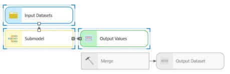

  1. Create two models: a main model and a submodel, in which the submodel is added to the main model. Add the Merge tool to the main model and the Iterate Feature Classes iterator and the Collect Values tool to the submodel.
  2. In the submodel, set the workspace containing the feature classes to be merged as the input for the Iterate Feature Classes iterator. To only iterate through point feature classes, set the Feature Type parameter of Iterate Feature Classes to POINT.
  3. Connect the Iterate Feature Classes output variable, Output Feature Class, to the Collect Values tool so the path of every point feature class in the workspace is iterated through and collected.

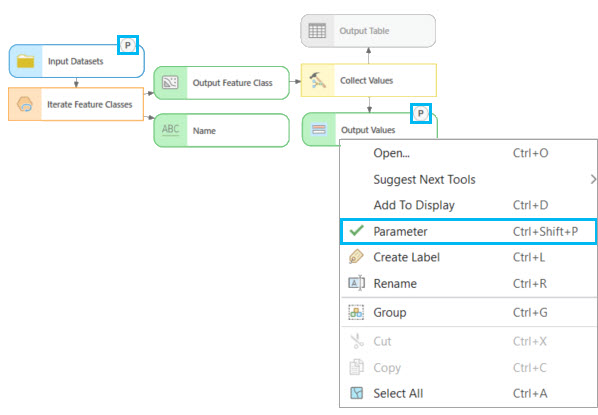

  4. Make the input workspace variable and the output of the Collect Values tool into model parameters. Rename the input workspace variable Input Datasets to ensure that the variable name is relevant and easy to understand.
    Setting submodel
  5. Save and close the submodel, then add it as a process to the main model. When the submodel is added to the main model, the submodel's parameters are automatically added as variables in the main model.
    Adding submodel
  6. Connect the output variable of the submodel as the Input Datasets parameter of the Merge tool. Make sure the Merge tool output has a valid path.
