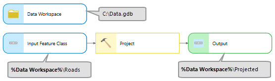

In the model illustrated below, a workspace variable, Data Workspace, has a value of C:\Data.gdb. This workspace location is substituted as an inline variable in the Project tool parameters by enclosing the variable name in percent symbols. At run time, the actual variable value, C:\Data.gdb, is substituted for %Data Workspace%.

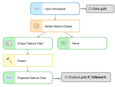

The use of model variable substitution is especially important when working with ModelBuilder iterators. When the iterator Iterate Feature Classes runs, it creates an output variable for both the path and name of each feature class in a workspace. You can use the value in the Name variable to construct the path to the output Projected Feature Class. When the tool executes, %Name% is replaced with the name of the feature class.
Use iterator output as the inline variable.

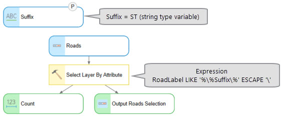

Model variable substitution can help you pass values entered by a user directly into a tool inside your model. For example, in the model illustrated below, Suffix is a model parameter that is specified when the model tool is run from the Geoprocessing pane. This variable is used in the Expression parameter of the Select Layer By Attribute tool as RoadLabel LIKE '%\%Suffix\%' ESCAPE '\'. When the tool runs, the expression works the same as RoadLabel LIKE '%ST' where the inline variable Suffix is replaced with the value ST, and only roads with label ending with ST are selected.
Use the inline variable in the Select Layer By Attribute tool.
Note:
The Suffix variable in this example is a string. You must enclose inline variables that are strings within quotation marks ('%Suffix%') in an expression. Inline variables that are numbers do not require quotation marks.

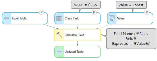

In a second example, inline variable substitution is used to pass values to the parameters of the Calculate Field tool. The model illustrated below contains two variables, Class Field and Value. Class Field with the value of Class is used as the Field Name parameter. The Value variable with the value of Forest is used as the Expression parameter. When the Calculate Field tool runs, the Class field gets the value of Forest that saves in the Value variable.
Use the inline variable in Calculate Field tool.

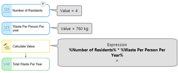

Calculate Value is a ModelBuilder utility that allows you to calculate a value based on a Python expression and use that value in your model. You can use model variable substitution to pass values from model variables into the Calculate Value Python expression or use the output variable name that stores the calculated value in another tool in your model.
The model below contains two numeric variables: Number of Residents and Waste Per Person Per Year. You can use these variables in the Calculate Value tool expression by enclosing them in percent symbols. When the Calculate Value tool runs, the variable names will be substituted with their values and multiplied together to calculate Total Waste Per Year.
Use the inline variable in the Calculate Value tool.

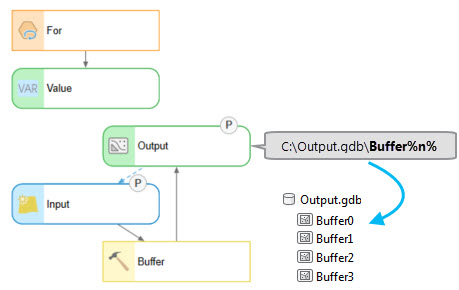

The variable %n% refers to the current model iteration (the first iteration is zero) when a model contains an iterator. For example, the For iterator is used to iterate a model four times. The output of the Buffer tool is used as feedback into the tool as input. The model iterates and creates an output at each iteration. %n% is used in the output name of Buffer to give the output of each iteration a new name.
Example of inline variable %n%.

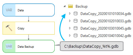

The variable %t% refers to the time when tool output is created. For example, if a model is scheduled to run daily for data backup, using the variable %t% creates an output with a time stamp to indicate the backup date.
Example of inline variable %t%.

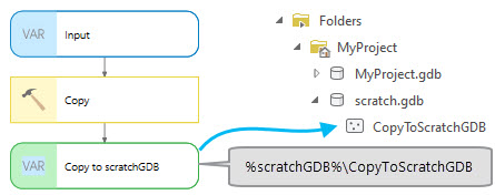

For example, if a tool output is specified as %scratchGDB%\CopyToScratchGDB, a scratch.gdb geodatabase is created, if it doesn't already exist, and the output CopyToScratchGDB is created in the Scratch GDB environment geodatabase.
Example of inline variable %scratchGDB%.

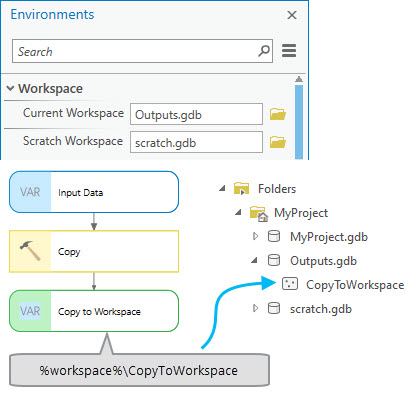

In the example below, if a tool output is specified as %workspace%\CopyToWorkspace, the output CopyToWorkspace is created in the Current Workspace environment location.
Example of inline variable %workspace%.
