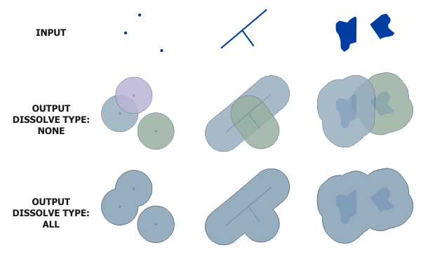

Illustration
Buffer tool illustration

Specifies the type of dissolve that will be performed to remove buffer overlap.
  • No Dissolve—An individual buffer for each feature will be maintained, regardless of overlap. This is the default.
  • Dissolve all output features into a single feature—All buffers will be dissolved together into a single feature, removing any overlap.
  • Dissolve features using the listed fields' unique values or combination of values—Any buffers sharing attribute values in the listed fields (carried over from the input features) will be dissolved.
String
