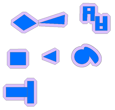

Illustration
Graphic Buffer tool illustration

    The tool illustration shows polyline features buffered using different Caps Type and Join Type parameter options.
