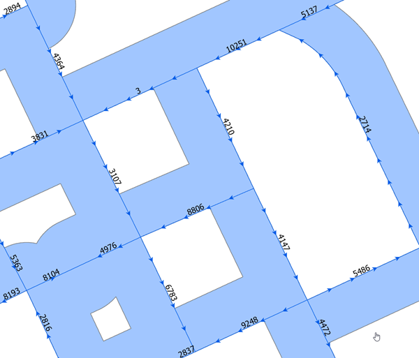

  • Dissolve all output features into a single feature—The input line features are first connected in a pseudo network as much as possible. The longest runs of connected line features in this network are then buffered on one side. Individual features are only buffered if they do not connect to any other features in the input. This works well for smaller distances (which are most often used for buffering lines representing roads and streams). In some cases, larger distances will result in output buffers that at first glance do not look correct, but larger buffers can cause an extreme amount of overlap that cannot be handled without post-tool interaction to make sense of the output.
    The one-sided buffer will attempt to keep resulting buffer output to the correct side even when output buffers interact with the incorrect side of other input line features.
    Side type buffer output with the Dissolve all output features into a single feature option

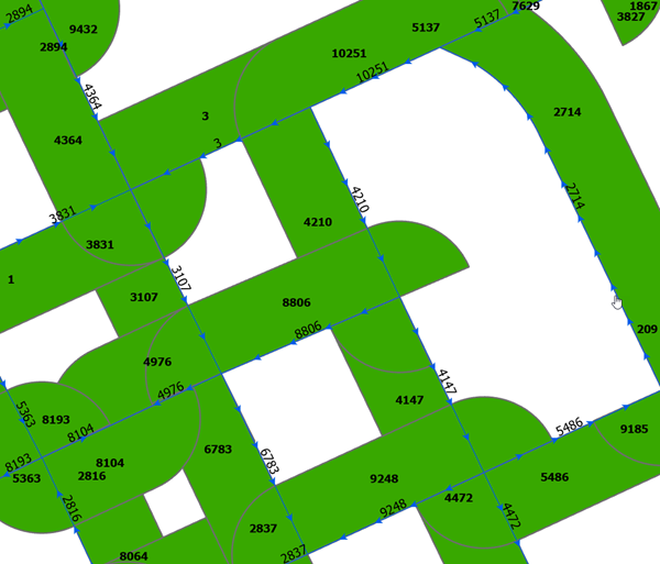

  • No Dissolve—One-sided buffer buffers the input lines individually. No considerations are made for the interaction of resultant buffers in the output.
    Side type buffer output with No Dissolve option

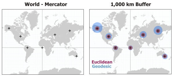

This example compares 1,000-kilometer geodesic and Euclidean buffers of a number of select world cities. Geodesic buffers were generated by buffering a point feature class with a geographic coordinate system, and Euclidean buffers were generated by buffering a point feature class with a projected coordinate system (in both the projected and unprojected datasets, the points represent the same cities).
When working with a dataset in one of the common projected coordinate systems for the whole world, such as Mercator, projection distortion may be minimal near the equator but significant near the poles. This means that for a Mercator projected dataset, distance measurements and buffer offsets should be quite accurate near the equator and less accurate away from the equator.
Geodesic and Euclidean buffers
The first graphic shows the input point locations. The equator and prime meridian are shown for reference. Both graphics are displayed in the Mercator (World) projection.
In the second graphic, the points near the equator have geodesic and Euclidean buffers that are coincident. For points near the equator, the Mercator projection produces accurate distance measurements. However, the buffers of points far from the equator show more distance distortion, as their Euclidean buffers are much smaller than the geodesic buffers. This occurs with the Mercator projection because at the poles, areas are stretched (land masses close to the poles, such as Greenland and Antarctica have enormous areas in comparison with the land masses close to the equator). All 1,000-kilometer Euclidean buffers are the same size since the Euclidean buffer routine assumes that map distances are the same everywhere in the projection (1,000 kilometers in Brazil is the same as 1,000 kilometers in central Russia). This is not true since away from the equator, the projection's distances become more and more distorted. With any type of analysis of distance on a global scale, use geodesic buffers, as they will be accurate in all areas while Euclidean buffers will not be accurate in high distortion areas.

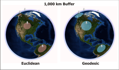

Note:
Displaying geodesic and Euclidean buffers on a globe will reveal that the geodesic buffers are more accurate.
Euclidean and geodesic buffers on a globe
These are the same 1,000-kilometer Euclidean and geodesic buffers that were created for the example above. When displayed on a globe, each of the Euclidean buffers is a different size despite the same buffer distance being used for each (the buffer in Alaska appears smaller than the buffer in Brazil). This is a result of the buffers being created with the false assumption that all of the map distances were the same from one location to another. Contrarily, each of the geodesic buffers is a correct uniform size when displayed on the globe; these geodesic buffers are correct because they were not influenced by distortion from a projected coordinate system.

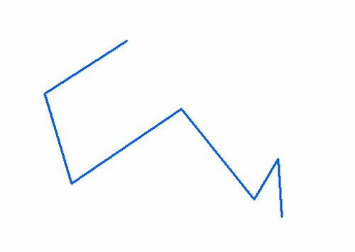

After using the Geodesic method, you may find little difference in the output buffers. This is because the shape-preserving geodesic method can be seen most obviously when the input features do not have an appropriate vertex density for the buffer creation process to maintain their shape (typically coarse, inaccurate features). It is important to know the input data before deciding to use the Geodesic method.
For example, the following image is a coarse feature with few vertices (vertices are only at the bends in the line) covering a large portion of the globe:
Input feature

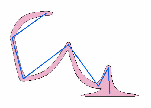

If you buffer this line by 500 kilometers using the Planar method, the following is the output buffer feature (pink):
Input with a buffer using the Planar method

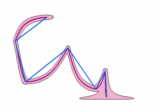

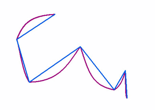

This may have been unexpected, but as mentioned earlier, when using the Planar method (when creating geodesic buffers), it is assumed that the vertices of the input polyline feature are connected with geodesic lines, as seen in purple below:
Input shown with assumed geodesic lines between vertices
Looking at the input features (blue), the resultant geodesic lines (purple), and the geodesic buffer (pink) together for this case, the output now makes sense:
The geodesic lines were buffered using the Planar method.
This is probably not what you want.

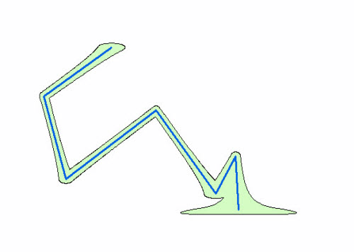

When using the Geodesic method, it is not assumed that the lines connecting vertices are connected by geodesic curves. The resulting geodesic buffer using the Geodesic method is shown below in green:
Shape preserved using Geodesic method
You now have a geodesic buffer that more closely maintains the shape of the input feature.

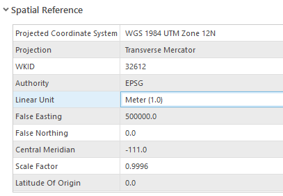

Spatial reference properties
Note:
BUFF_DIST value units are always those of the Output Coordinate System environment when it is set.
