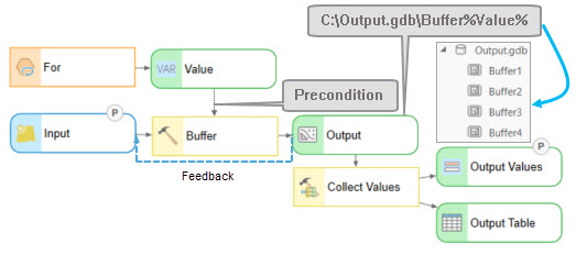

Since the model produces one output dataset for each iteration, it is important to have a unique output name for each iteration so the previous iteration output is not overwritten. To assign a unique name to each iteration output, append the output path with the inline variable substitution, as shown in the example below.

The example model below shows how to use the Buffer tool and a feedback loop to iteratively create multiple rings of buffers.
Using feedback loop
The Buffer tool and a feedback loop are used together.
  1. To run the feedback loop a specific number of times, use the For tool. Enter an appropriate value for From Value, To Value, and By Value.
    For example, to iterate the model four times, set a starting From Value of 1, an ending To Value of 4, and an interval By Value of 1.
  2. Make the output of the For tool a precondition to the next tool.
    This ensures that the iteration number is available before the next tool runs.
  3. To avoid overwriting the output of each iteration, append the output name with the %Value% inline variable.
    When the model runs, %Value% will be replaced by the number from the output Value of the For tool.
  4. Connect the output of Buffer to the Input variable as feedback so the previous buffered output is used as input in the next iteration.
  5. Connect the output of Buffer to the Collect Values tool.
    To run a model with a feedback loop from the Geoprocessing pane, connect the final output of the model to the Collect Values tool. Make the output of Collect Values a model parameter so the feedback outputs are added to the map.
  6. Run the model.
