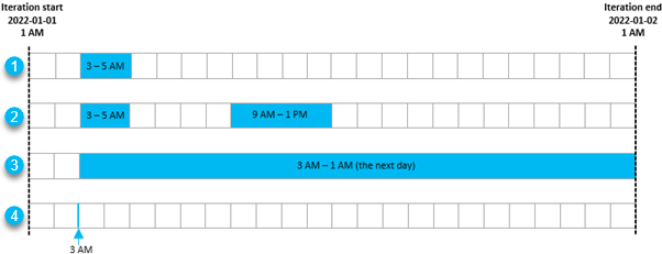

  • Use the Subset parameter to create one or more subsets of each temporal slice. The table below shows examples of different Subset Delay and Subset Duration values with the assumption that the temporal slice is from January 1, 2022, 1 AM (2022-01-01 01:00:00) to January 2, 2022, 1 AM (2022-01-02 01:00:00). The numbers in the Case column correspond to the numbers in the image below the table.
    Case
    Subset value
    Result
    Subset Delay: 2 Hours
    Subset Duration: 2 Hours
    Data from 3 AM (2022-01-01 00:03:00) to 5 AM (2022-01-01 00:05:00) will be returned.
    Subset Delay: 8 Hours
    Subset Duration: 4 Hours
    Data from 3 AM (2022-01-01 00:03:00) to 5 AM (2022-01-01 00:05:00), and from 9AM (2022-01-01 00:09:00) to 1 PM (2022-01-01 00:13:00) will be returned
    Subset Duration: None
    Data from 3 AM (2022-01-01 00:03:00) to the next day 1 AM (2022-01-02 00:01:00) will be returned.
    Subset Duration: 0 Hours
    Data from 3 AM (2022-01-01 00:03:00) will be returned.
    Iterate Time subset examples

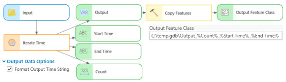

  • The two output parameters, Start Time and End Time, are in 24-hour format. If no time is specified in the data or in any parameter values, the default cutoff time is 00:00:00.
  • The Start Time and End Time parameter values can be used as inline variable substitution to define the output names in other tools. To do so, check the Format Output Time String parameter to return a date and time string without special characters as in the example below.
    Tool outputs as inline variable substitution

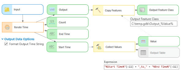

    The time is always appended to the start and end time strings. To remove time from that string, use the Calculate Value tool and set the expression to "%Start Time%"[:11] + "_to_" + "%End Time%"[:11]. The output of the Calculate Value tool can then be used as inline variable substitution in the output of the Copy Features tool.
    Tool outputs without time as inline variable substitution
