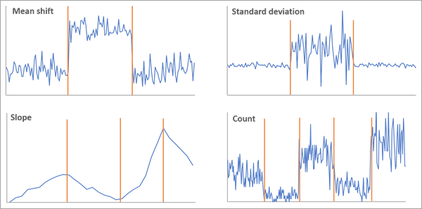

Illustration
Change Point Detection tool illustration
