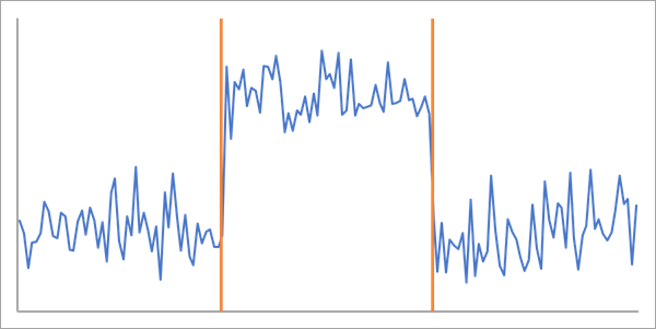

  • Mean shift—Detects shifts in the mean value of the analysis variable. The data values are assumed to follow a normal distribution with all time steps having the same standard deviation. The mean value is constant within each segment and changes to a new value at each change point.
    Mean shift change type

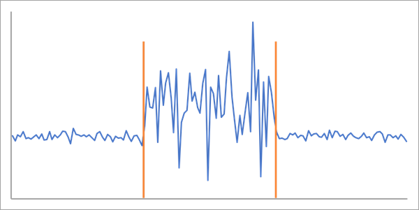

  • Standard deviation—Detects changes in the standard deviation of the analysis variable. The data values are assumed to follow a normal distribution with all time steps having the same mean value. The standard deviation is constant within each segment and changes to a new value at each change point.
    Standard deviation change type

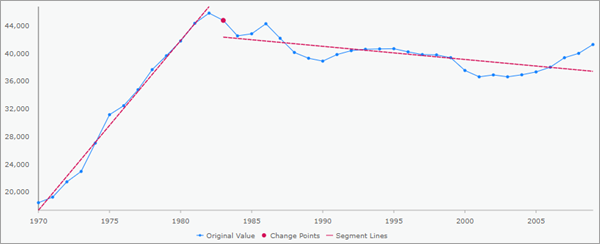

  • Slope (Linear trend)—Detects changes in the linear trend of the analysis variable. The data values are assumed to follow a normal distribution with a mean value defined by a line and all time steps having the same standard deviation. The slope and intercept of the line are constant within each segment and change to new values at each change point.
    Slope (Linear trend) change type

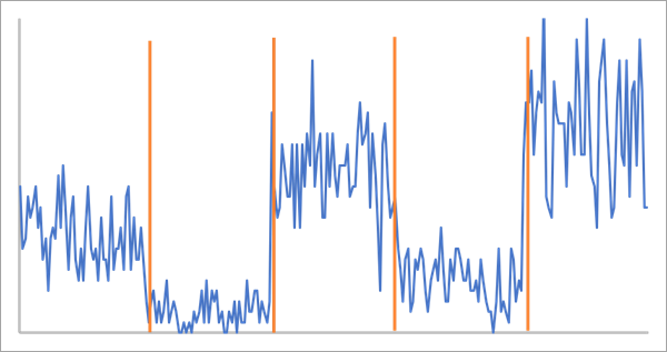

  • Count—Detects changes in the mean value of an analysis variable representing counts. The data values are assumed to follow a Poisson distribution within each segment with a mean that changes to a new value at each change point.
    Count change type

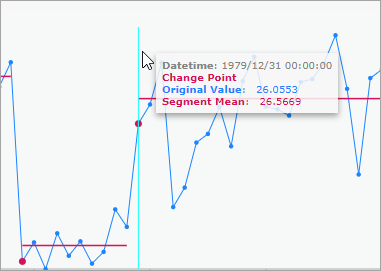

Clicking any feature on the map using the Explore navigation tool displays a line chart in the Pop-up pane. The chart displays a blue line chart of the time series at the location with change points indicated by larger red dots.
For the Mean shift and Count change types, horizontal red lines are drawn at the mean value of each segment.
Mean and count pop-up chart
For the Slope (Linear trend) change type, red lines are drawn showing the linear trend of each segment.
Slope (Linear trend) pop-up chart

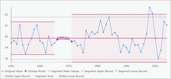

For the Standard deviation change type, a solid red line is drawn at the global mean value of the entire time series. For each segment, dashed red lines are drawn two standard deviations above and below the global mean with pink shading between the bands. These bands widen or narrow when the standard deviation changes at the change points. Dashed gray lines are drawn two global standard deviations above and below the global mean. This allows you to determine whether the standard deviation of a segment is larger or smaller than the standard deviation of the entire time series.
Standard deviation pop-up chart

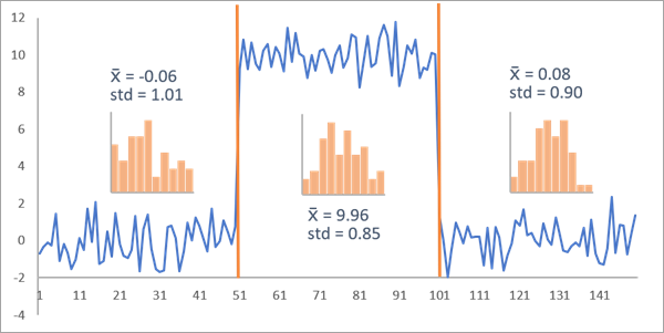

For example, the image below shows a time series with 150 time steps where all values were generated from a normal distribution with standard deviation equal to 1. The mean of the first 50 time steps is 0, then the mean increases to 10 for the middle 50 time steps, then decreases back to 0 for the final 50 time steps. Change points are defined as the first time steps in each new segment, so for this time series, time steps 51 and 101 are the true change points when the mean shifts. The histograms of the individual segments show that each segment appears to follow a normal distribution with approximately equal standard deviation but different mean value, so this segmentation appears to align with the assumptions of the mean shift change type. This indicates that the likelihood of this segmentation is high, and the resulting segmentation cost is low. For this correct segmentation, the segmentation cost is 401.39 when detecting mean shift. This value is difficult to interpret on its own, but it can be compared to the cost of other possible segmentations.
Optimal segmentation

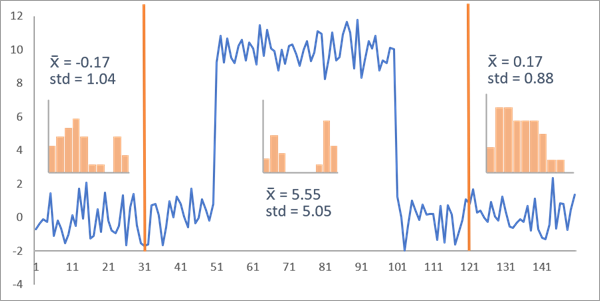

The image below shows an incorrect segmentation where time steps 31 and 121 are detected as change points. The middle segment does not appear normally distributed and has a much larger standard deviation than the first and last segments. This suggests that the data values of the segments are unlikely under the distributional assumption of the mean shift change type, so the segmentation cost should be high. Indeed, the cost of this segmentation is 2596.24, which is much larger than the cost of the correct segmentation. This confirms that these change points are not optimal for this time series.
Nonoptimal segmentation

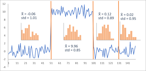

Now, suppose an unnecessary change point is added in addition to the two true change points. In the image below, time steps 51, 101, and 131 are identified as change points. While the last change point is unnecessary, the segment histograms do appear normally distributed with approximately equal standard deviation, indicating a high likelihood and low segmentation cost. The cost of this segmentation is 401.27, which is slightly lower than the cost of the true segmentation (401.39). The segmentation with an unneeded change point has a lower segmentation cost than the true segmentation because likelihoods never decrease by including new parameters (in this case, new change points). The inclusion of the extra change point only decreased the cost by a small amount because it provided very little improvement to the fit of the model to the data, compared to not being included as a change point.
Segmentation with unnecessary change point
