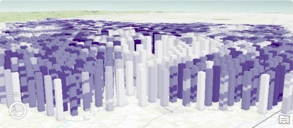

Value
With the Value option, the raw numeric value of the Cube Variable parameter value is displayed for each bin in the space-time cube. This can be particularly important to visualize if you are aggregating during cube creation by either aggregating points into bins or temporally into locations. An example is shown below.
Output of the Value display theme in the Visualize Space Time Cube in 3D tool

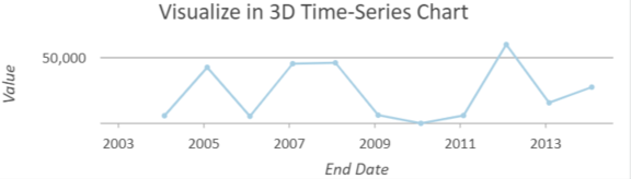

A chart is also created displaying the value over time for the entire space-time cube. An example is shown below.
Chart output of the Value display theme in the Visualize Space Time Cube in 3D tool

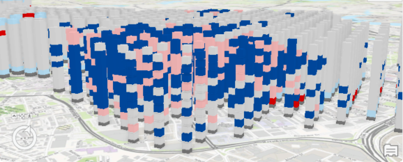

Hot and cold spot results
The Hot and cold spot results option shows the statistical significance of each bin based on the space-time hot spot analysis run in the Emerging Hot Spot Analysis tool. The tool calculates the Getis-Ord Gi* statistic for each bin based on the neighborhood set in the tool run. The Emerging Hot Spot Analysis results option in 2D identifies trends in these results. An example is shown below.
Output of the Hot and cold spot results display theme in the Visualize Space Time Cube in 3D tool

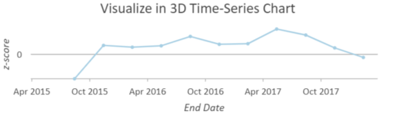

A chart output is also created plotting the z-scores over time for the entire cube. An example is shown below.
Chart output of the Hot and cold spot results display theme in the Visualize Space Time Cube in 3D tool

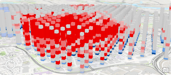

Cluster and outlier results
The Cluster and outlier results option displays the COType attribute assigned to each bin from the space-time analysis run in the Local Outlier Analysis tool. The tool calculates the Anselin Local Moran's I statistic for each bin based on the neighborhood parameters set in the tool run. The Local Outlier Analysis results option in 2D categorizes these results by location. An example is shown below.
Output of the Cluster and outlier results display theme in the Visualize Space Time Cube in 3D tool

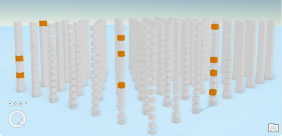

Estimated bins
When the cube is created, some bins may have been estimated using the Summary Fields or Fill Empty Bins with parameters. Bins with estimated values are displayed with the Estimated bins display option. This can be useful information for locations that have many estimated bins in sequence either at the beginning or end of the time series at a location, as you may not be able to confirm the accuracy of forecasting results in these particular locations. An example is shown below.
Output of the Estimated bins display theme in the Visualize Space Time Cube in 3D tool

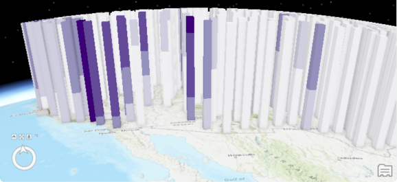

Forecast results
The Forecast results option displays the results of the forecast method for the selected Cube Variable parameter value. The original time steps of the Input Space Time Cube parameter and the forecasted values added from time series forecasting are displayed. An example is shown below.
Output of the Forecast results display theme in the Visualize Space Time Cube in 3D tool

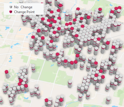

Time series change points
The Time series change points option displays the detected change points in 3D. Time steps that are detected as change points are drawn in purple and labeled Change Point, and time steps that are not detected as change points are drawn in light gray and labeled No Change. An example is shown below. The output will contain fields indicating whether each time step is a change point along with estimates of the mean or standard deviation for the current and previous time step.
Output of the Time series change points display theme in the Visualize Space Time Cube in 3D tool

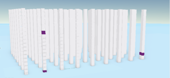

The Time series outlier results option displays the temporal outliers found when using the Outlier Option parameter in the Time Series Forecasting tools for the specified Cube Variable parameter value. An example is shown below.
Output of the Time series outlier results display theme in the Visualize Space Time Cube in 3D tool

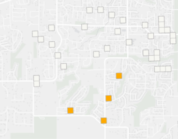

Locations with data
The Locations with data option allows you to see all locations that contain data for the selected Cube Variable parameter value and drops locations for areas where no points were aggregated. This option is always available for every cube created by aggregating points. An example is shown below.
Output of the Locations with data display theme in the Visualize Space Time Cube in 2D tool

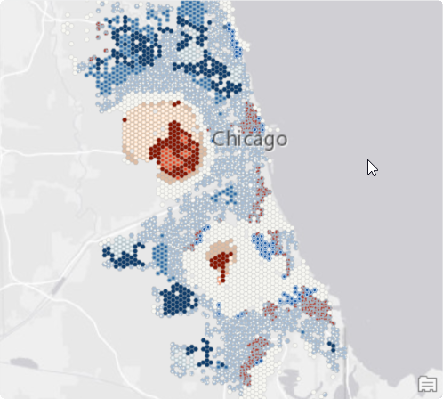

With the Emerging Hot Spot Analysis results option, the results of the Emerging Hot Spot Analysis tool that are stored in the space-time cube for each location are re-created and displayed. These results identify trends for each location in the cube including new, intensifying, or diminishing hot spots and cold spots. An example is shown below.
Output of the Emerging Hot Spot Analysis results display theme in the Visualize Space Time Cube in 2D tool

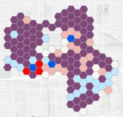

With the Local Outlier Analysis results option, the results of the Local Outlier Analysis tool are re-created and displayed. These results indicate significant clusters and outliers in the space-time cube by bin and categorize each location by results over time. An example is shown below.
Output of the Local Outlier Analysis display theme in the Visualize Space Time Cube in 2D tool

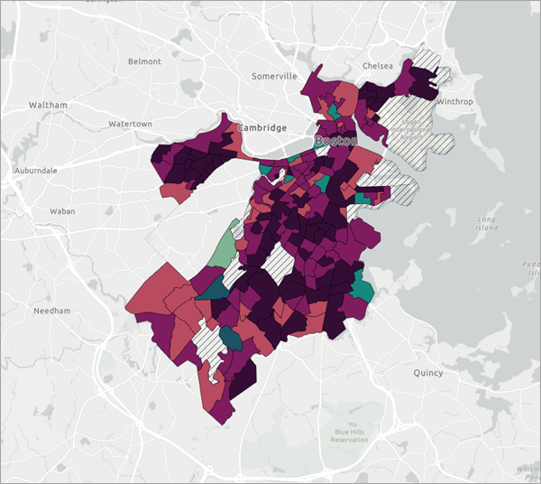

Locations excluded from analysis
The Locations excluded from analysis option displays locations that did not meet the requirement for estimation for the specified analysis. An example is shown below.
Output of the Locations excluded from analysis display theme in the Visualize Space Time Cube in 2D tool

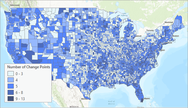

The Time series change points option displays the number of change points detected at each location. An example is shown below.
Output of the Time series change points display theme in the Visualize Space Time Cube in 2D tool

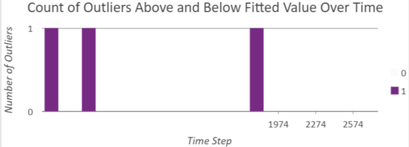

The Time series outlier results option also outputs a bar chart showing the number of temporal outliers for each time step. An example is shown below.
Output of the Time series outlier results display theme in the Visualize Space Time Cube in 2D tool

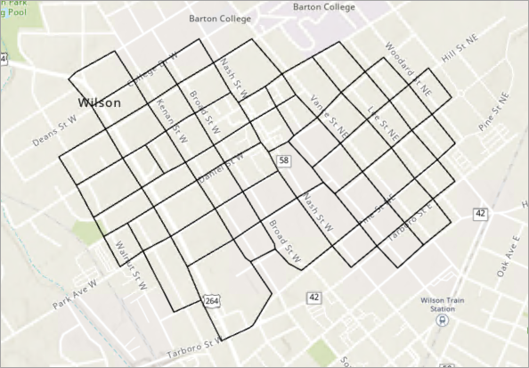

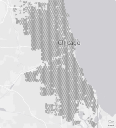

Footprints
The Footprints option outlines all the locations for the selected variable. The layer ignores masks and displays the full spatial extent of the variable. This option is available for all space-time cubes. An example is shown below.
Output of the Footprints display theme in the Visualize Space Time Cube in 2D tool
