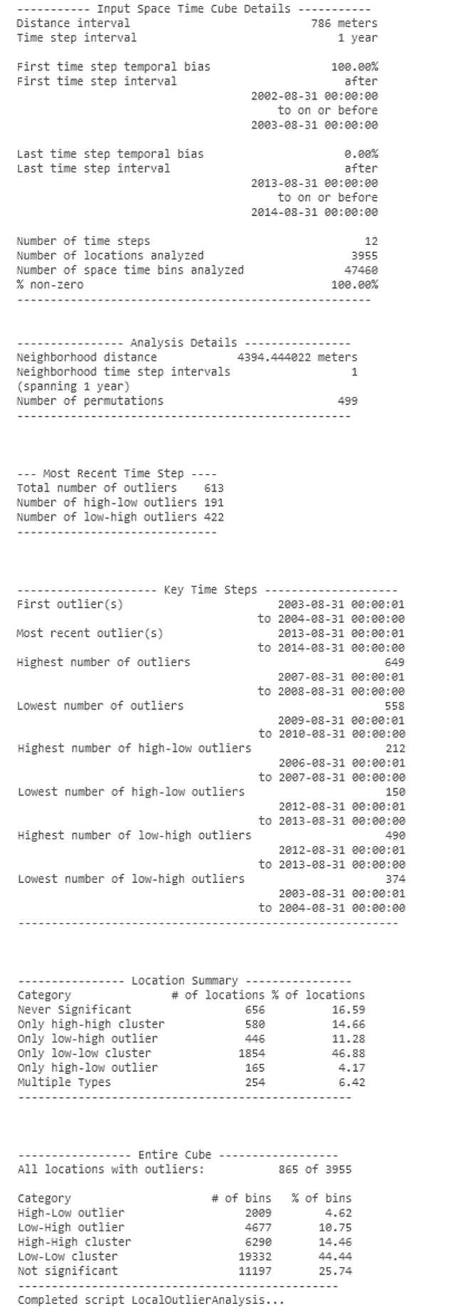

In addition, messages summarizing the analysis results are written at the bottom of the Geoprocessing pane during tool implementation. You can access the messages by hovering over the progress bar, clicking the pop out button , or expanding the messages section in the Geoprocessing pane. You can also access the messages for a previously run tool via the Geoprocessing History.
These messages include information about the Input Space Time Cube parameter value, such as time span, temporal bias, and the number of bins and locations analyzed. The messages also include important information about any outliers that occurred in the most recent time step as well as summarizing key time steps that may be of interest. For instance, if your question involves finding underperforming areas in your sales territory and you are looking for low-high outliers, the messages will provide you with the key time step that had the highest number of low-high outliers.
Local Outlier Analysis messages example
