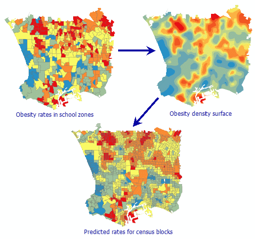

Polygon-to-polygon data reaggregation workflow
Reaggregating polygonal data (for example, downscaling population counts) is a two-step process. First, a smooth prediction surface for individual points is created from the source polygons (this surface can often be interpreted as a density or risk surface); then, the prediction surface is aggregated back to the target polygons. Creating the prediction surface requires interactive variography, so it must be done in the Geostatistical Wizard. The output from the Geostatistical Wizard is a geostatistical layer of predictions or prediction standard errors. If reaggregation to new polygons is not required, the workflow can end here.
Once a prediction surface has been created, aggregation back to a different set of polygons is done with the Areal Interpolation Layer To Polygons geoprocessing tool. The graphic below shows the workflow for predicting obesity rates in Los Angeles census blocks from obesity rates in Los Angeles school zones.
Polygon-to-polygon reaggregation
The mathematical details of the disaggregation and reaggregation can be found in the paper referenced at the end of this topic.

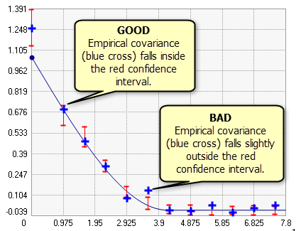

The default covariance curve often does not fit the data well. In this case, the variography parameters need to be altered. Fitting a proper covariance curve is often difficult, and the best way to get better at fitting is simply to practice, but the following are a few rules of thumb that can help to fit a good model:
  • Decrease the Lag Size value until the empirical covariances are no longer negative.
  • If the model still doesn't fit, experiment with the Model parameter. K-Bessel and Stable are the most functional models, but they also take the longest to process.
  • If you find a combination of Lag Size and Model that nearly fits, try decreasing the Lattice Spacing value. However, be aware that decreasing the lattice spacing will rapidly increase the processing time. The lattice spacing parameter is described in the New parameters for areal interpolation section below.

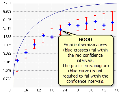

As seen in the graphic below, if Function Type is changed to Semivariogram, the semivariogram curve for points (the blue line in the graphic below) might not pass through the confidence intervals. This is not a problem, and the criteria for a good model does not change: if a large percentage of the empirical semivariances fall within the confidence intervals, you can be confident in the accuracy of your model.
