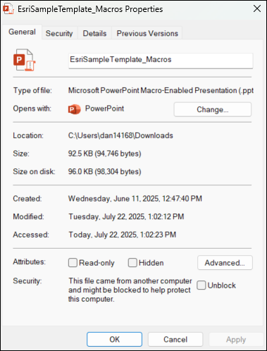

  1. Download the template to your local directory: C:\ProgramFiles\ArcGIS\Pro\Resources\MotionImagery.
  2. Right-click the PowerPoint file, and click Properties.
    The Template Properties dialog box appears.
  3. Click the General tab.
  4. In the Security section of the General tab, check the Unblock check box.
  5. Click OK.

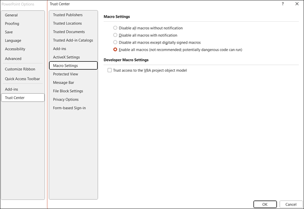

  3. Click Trust Center, and click Trust Center Settings.
    The Trust Center dialog box appears.
  4. Click Macro Settings.
  5. Under Macro Settings, click Enable all macros (not recommended, potentially dangerous code can run).
  6. Click OK to close the Trust Center dialog box.

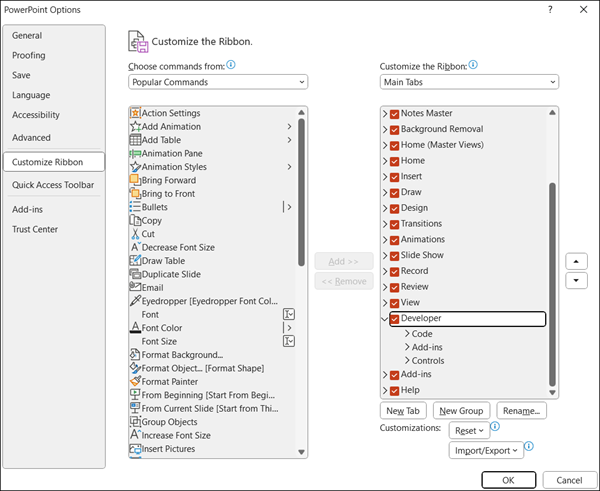

  7. In the PowerPoint Options window, click Customize Ribbon.
  8. For Customize the Ribbon, select Main Tabs from the drop-down list, and check the Developer check box.
    The Developer tab is added to the ribbon.
  9. Click OK to close the PowerPoint Options window.

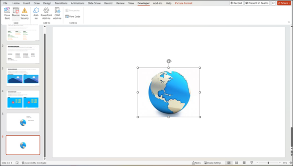

  1. Add an image to the PowerPoint slide as a placeholder.
  2. Select the image, and click Macros on the Developer toolbar.
    Image selected in the template before setting the macro
  3. In the Macro window, select TagFrameImage from the list.
    Macro window with TagFrameImage selected
  4. Click Run.

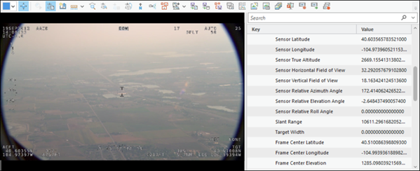

  2. To see the available fields, click the Display Metadata button on the side of the video player window.
    Any metadata field populated in the stream can be used in the export.
    Metadata stream in the video player
  3. Type the metadata field name in curly brackets in the text box.
    For example, type {Sensor Latitude} to include Sensor Latitude in the template from the metadata.
