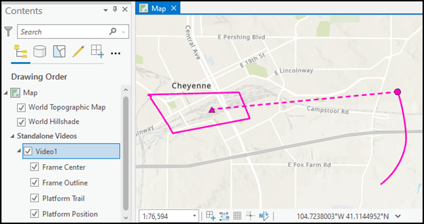

Contents pane
When you add a video file to a map, the video file is listed in the Contents pane. Also listed are the individual elements associated with the video, including Frame Center, Frame Outline, Platform Trail, and Platform Position values. Check the check boxes next to the elements in the Contents pane to display them in the map view.
Video file and associated elements in the Contents pane and on the map
Note:
Once the elements are checked or unchecked, you may need to select play in the video player to update them on the map.
Select Data Source in the Properties pane to expand video files and display KLV stream elements. You can turn the KLV stream display on and off when the .ts file has one or more KLV streams. Uncheck the KLV stream to turn off the KLV data from processing. By checking the check box, KLV elements can be enabled or disabled for viewing on the map. When using Metadata to CSV or Metadata to Features, the checked KLV stream passes data to the export process. If no KLV elements are checked, the video will maintain the latest known data, and the video file will continue to play in the video viewer with updates to the map.

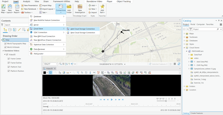

Video playback from cloud storage
You can add an Amazon .acs file to the map using Add Cloud Storage Connection on the Insert tab. Right-click the video file in the Catalog pane, and select Add To Current Map. The video file will be listed in the Contents pane in the Standalone Video section.

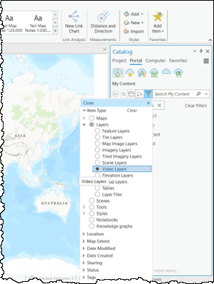

Video playback from a portal
When signed in to a portal with an installed video server, you can consume a video layer and add it to the map in ArcGIS Pro. Through the portal connection, you can use the Item Type, Layers, and Video Layers filters, as well as other options.
Filter videos
Right-click the video layer in the Catalog pane, and select Add To Current Map. The video layer will be listed in the Contents pane in the Standalone Video section, and the video player will be initialized.

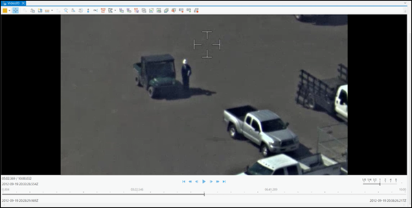

Control playing of the video in the video player
To play an archived video file, browse to the video file and add it to the Contents pane or the display. The video player opens with the video file loaded and docked below the map. The video player can be moved and placed anywhere on your display. It can be resized by moving a corner or edge of the player.
Choose a color to identify the video file and the associated graphics—such as a video footprint—on the map, and feature class data you want to collect on the video.
Video displayed in the player and footprint displayed on the map

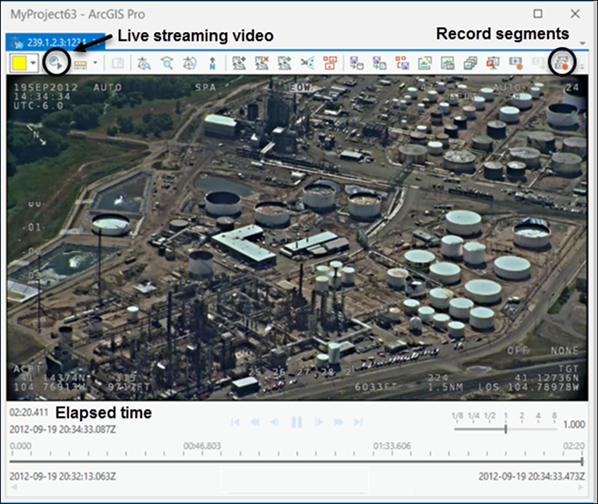

Video frame information display
Information about each video frame is displayed in the video player in real time as the archived video is played.
Video player information display
The user interface items that are numbered in the image above are described in the following table:

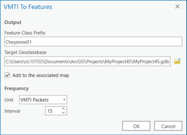

VMTI To Features
VMTI to Features
Save VMTI centerpoint data to a geodatabase.

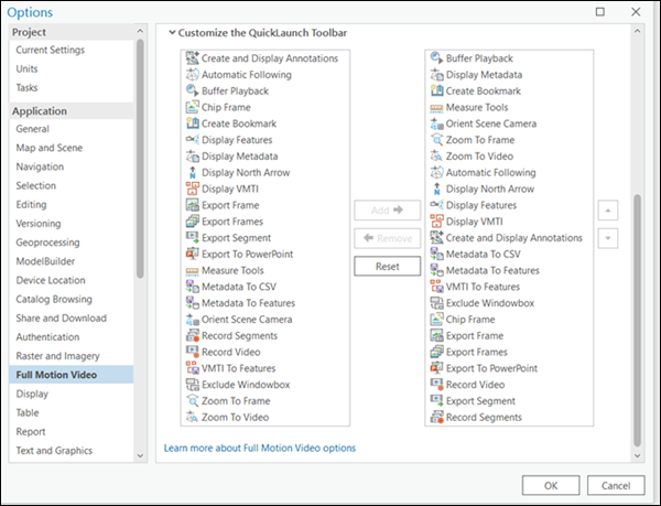

In addition to accessing tools on the video player, you can access commonly used tools and controls by right-clicking in the video player. A menu of choices is displayed that includes Zoom To Frame, Zoom To Video, Send To Map, Send To Clipboard, Export To PowerPoint, and Search Frame Extent.
QuickLaunch toolbar
Due to the increasing capabilities of the video player in ArcGIS Pro, additional controls for interacting with the video and map are available. Not all buttons are used by all analysts, so you can configure the video player buttons to customize the video player for your instance of ArcGIS Pro.
Customize the QuickLaunch Toolbar section
Expand the Customize the QuickLaunch Toolbar section to establish the tools in the video player pane. Select an item in the first panel, and click Add to move the item to the second panel, which displays and enables the item in the video player pane. Use the following keyboard shortcuts with the Customize the QuickLaunch Toolbar interface:
  • Press R—Remove enabled buttons from the list.
  • Press A—Add a button to the enabled buttons list.

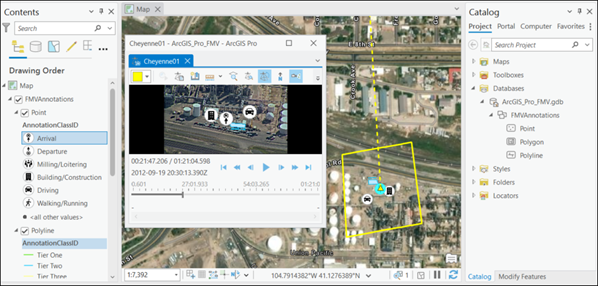

Display Features tool
Feature classes that are loaded into the Contents pane and displayed on the map can also be displayed on the video in the various play modes. Click the Display Features button to display and link features in both the video player and the map.
Features can be created or edited on the map or the video player, and the results are displayed in either viewer. The feature creation and editing experience is consistent with ArcGIS Pro. Additionally, .kml and .kmz files can be loaded into the map and video display.
Features listed in the Contents pane and displayed in the video player and map
Create features in either the video player or the map and see the results displayed in both views.

Click the VMTI To Features button to save all the objects identified in each video frame to a geodatabase. Specify the file name and location of the geodatabase, and the data capture Frequency value for the objects identified. The recorded feature class data includes the centerpoint of each object detected and all the FMV metadata related to the associated video frame. The associated feature attribute table allows you to use existing geoprocessing tools to create object tracks and other statistical information for VMTI features.
VMTI To Features dialog box
Specify the path, file name, and capture frequency of the objects to be identified in the VMTI-enabled video.
If you have VMTI information in a separate file associated with a specific video, you can encode it into the video file using the Full Motion Video multiplexer. See the Video Multiplexer tool documentation for details.

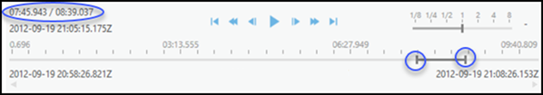

Export a segment using the Export Segment tool
To interactively define the start and end of the segment of the video you want to clip and export, complete the following steps:
  1. Click the Export Segment button.
  2. Click the handle at the beginning of the time slider and move it to the point in the video where you want to begin the export.
  3. Click the handle at the end of the time slider and move it where you want to end the clip.
    Export a video segment using the time slider.
    See the video playback during manual adjustment of each handle. The time stamp indicates the position in the video of the beginning or end clip handle on the slider. To return the handles to their original position, double-click one of the handles. Alternatively, you can drag both handles to the beginning and end of the original video.
    A dialog box appears for you to specify the directory and file name
  4. On the dialog box, choose a supported video file type, and provide a file name.
    The portion of the video between the two handles is saved in a separate file.

Record a live streamed video in segments
You can store a segment of a live streamed video in memory so that you can interact with it. This is similar to interacting with an archived video file. You can operate the time slider along the video segment, and use the tools to save a video frame as an image, export a clip, export a frame to PowerPoint, or use another operation.
You can store multiple video segments in memory; the previous segment is overwritten by the new segment. To configure the buffer, click Project > Options > Video > General > Video Exports. This feature may be restricted by system resources. When Buffer live-streams is selected, the live-streamed video is stored in a temporary location as a manifest.ts file. This file can be moved into the map and played back as an archived video. You can also use the Set custom folder for saving live-streams option.

Video player live stream tools
The live stream video resumes playing, and the Elapsed time indicator displays the current time since the live stream video was initiated.
