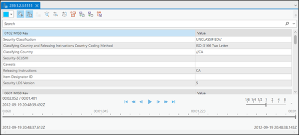

You can search the metadata fields by keyword while the video file is playing.
Video frame information display
Information about each video frame is displayed in the metadata player in real time as the archived video is played.
Video player information display
The user interface items that are numbered in the image above are described in the following table:
Information display
Description
1—Video playback slider handle
The video playback slider handle indicates the relative location within the video timeline that is displayed in the metadata player. Click the video playback slider handle and move it along the playback slider.
2—Metadata timestamp
The coordinated universal time (UTC) stamp in human-readable format is displayed as the video plays. This time stamp reflects the position of the video slider along the video file timeline. Click to update the jump-to-time stamp functionality.
3—Video play time position
Displays the time of the current video frame relative to the total time of the video file. Time is displayed in 12-hour format.
4—Video start time
The date and time at the start of the video file.
5—Video end time
The data and time at the end of the video file.
6—Adjust playback rate
Adjust the playback rate with the fine-tune slider as the video plays, and the metadata player adjusts and plays at the new rate.
7—Player controls
The video playback controls, such as play, pause, fast-forward, and others. The playback controls are described in more detail below.
