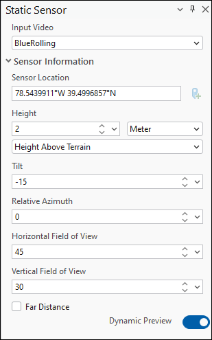

Sensor Information
Using the Sensor Information set of prompts, generate the required video metadata needed for Motion Imagery tools. The more information you can provide, the better your resulting video footprint and functionality.
Generate video metadata sensor information.
You have two options to set the Sensor Location. You can either manually enter or paste the sensor coordinate, or use the Point Select Tool.
Note:
You must have the Map window selected for the coordinate selector tool to be enabled.
The Height parameter allows you to offset a sensor vertically. Once the height has been input, you must specify the units and whether the height is above terrain, an ellipsoid, or mean sea level.
The following parameters will help provide the best possible footprint for the video, allowing Motion Imagery tools to work with the video metadata:
  • Tilt—The up and down movement of a sensor, where the vertical angle capture views above or below the horizon. Positive values are pointed upward, negative values are pointed downward, and 0 degrees is level with the horizon.
  • Relative Azimuth—The left and right movement of a sensor. A zero value is pointed due north and 180 degrees is due south.
  • Horizontal Field of View—The angular width of a sensor's view horizontally. Smaller values represent a narrow view and larger values have a wide-angle view.
  • Vertical Field of View—The angular height of a sensor's view vertically. Smaller values represent a narrow vertical view, and larger values show a larger span above and below the frame center.
  • Far Distance—The farthest distance at which a sensor is able to discern the desired objects in the video. Once this optional box is checked, you can set the distance and unit of measure.
Dynamic Preview—Allows you to see the footprint on the map before running the tool, if parameter values are entered.
