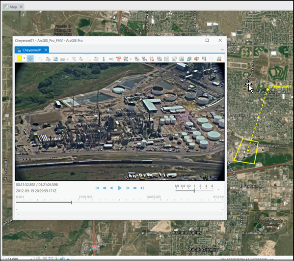

The geospatial video capability in the ArcGIS Image Analyst extension allows you to include motion imagery and video in ArcGIS Pro projects including playback and geospatial analysis capabilities for metadata compliant videos. Geospatial video refers to the combination of a video stream and associated metadata into one video file, which makes the video geospatially aware. The sensor systems collect camera orientation, platform position and attitude, and other data and encode it into the video stream so that each video frame is associated with geopositional information.
This geospatially enabled video data, along with the computational functionality of ArcGIS Pro, allows you to view and manipulate the video while being fully aware of the sensor dynamics and field of view (FOV), and display this information in the map view. It also allows you to analyze and edit feature data in either the video view or the map view, providing telestration capability.
Video player with video footprint and sensor ground track displayed on the map
Motion imagery tools in ArcGIS Pro use the metadata to seamlessly convert coordinates between the video image space and map space, similar to the way that the image coordinate system in image space analysis transforms still imagery. This conversion provides the foundation for interpreting video data in the full context of all other geospatial data and information in your GIS. For example, you can view the video frame footprint, frame center, and position of the imaging platform on the map view as the video plays, together with GIS layers such as buildings with IDs, geofences, and other pertinent information.

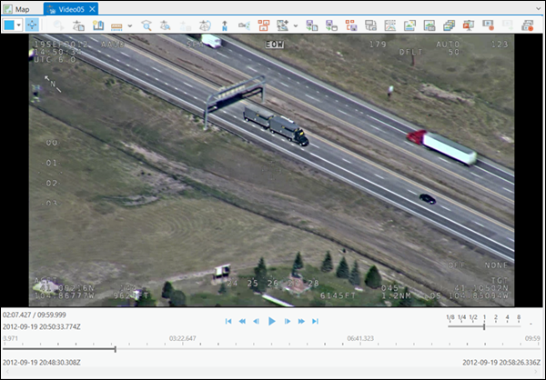

Video player
The video player includes standard video controls such as play, fast forward, rewind, step forward, step backward, jump to the beginning, or jump to the end of the video. You can zoom in to and roam a video while it is in play mode or in pause mode. The video player works with the map, global scenes, and local scenes. The Orient Scene Camera feature orients the scene view camera to the perspective of the video sensor and is only enabled for local and global scenes.
Video player

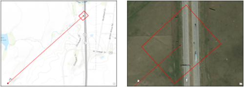

Video footprints on the map
Additional tools include capturing, annotating, and saving video bookmarks; capturing single video frames as images; and exporting video clips.
