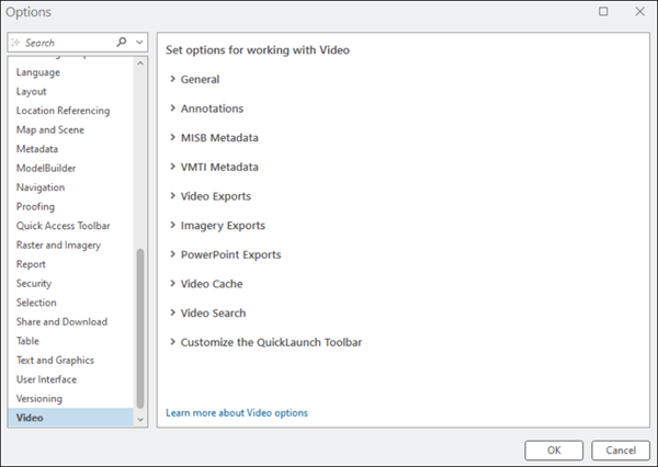

  3. Click the Options tab, and click Video to display the Set options for working with Video page.
    Project options for working with video

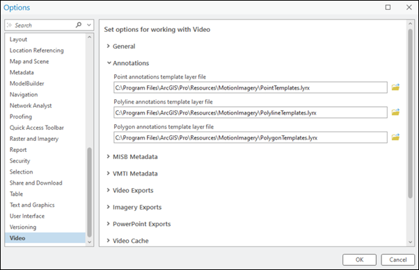

  5. Expand the Annotations section to specify template layer files for point, polyline, and polygon features.
    Define Video annotation templates.

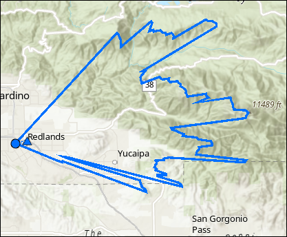

You can set the ground elevation surface for a project in the global project settings. Specifying a ground elevation source enables more accurate measurements of objects and features in the video, calculation and display of video frame footprints influenced by topography, and collection and editing of z-aware features.
Video frame footprint influenced by topography
