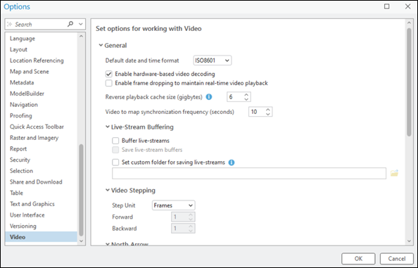

The Synchronization group provides tools to synchronize multiple videos. It contains the Map Time To Video tool, which synchronizes the map time with the date and time of the video. Click the clock button in the map to show all the features with time stamps that match the current video time stamp. The feature layer must be time enabled, loaded in the Contents pane, and active in the map. Video-to-map synchronization frequency (seconds) can be set on the Full Motion Video Options page.
