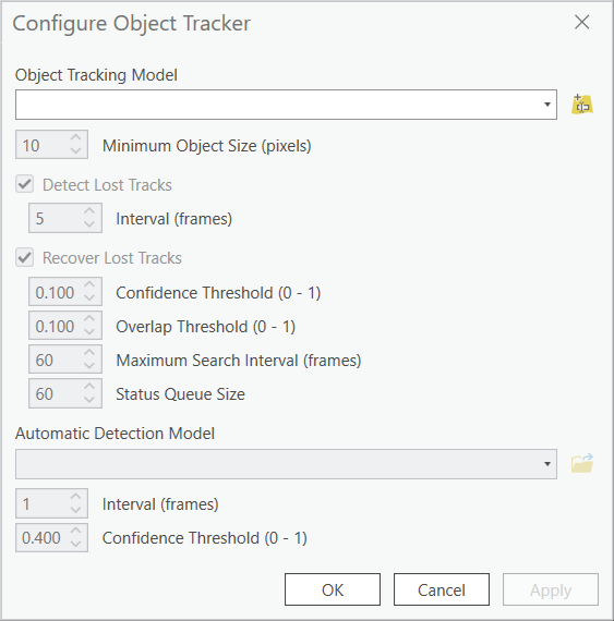

Click the Configure Tracker button to open the Configure Object Tracker pane. The pane contains the Object Tracking Model and Automatic Detection Model settings.
Settings
Use the Object Tracking Model parameter to choose the deep learning model and set additional parameters for tracking objects.
Click the browse button to open the Add Deep Learning Model From Path dialog box. Specify the path to the deep learning model package file (.dlpk) by providing a URL or by browsing to the file in a local directory. You can assign an alias for the model's name in the Model text box. Click Add to load the model and close the dialog box. The model name appears in, and is selected from, the Model drop-down list.
The settings contain options to control object tracking, including Minimum Object Size (pixels), Detect Lost Tracks, Recover Lost Tracks, and Auto Detection Model.
  • Detect Lost Tracks—Specify whether the object is successfully tracked based on changes in appearance, such as changes in view angle, obscuration, or movement out of the frame. The default is checked.
    • Interval (frames)—Set the interval, in number of frames, at which the application checks for object appearance changes. The default is 5.
  • Recover Lost Tracks—Specify whether an attempt is made to find an object after the track has been lost. The default is checked.
    • Confidence Threshold (0-1)—Set the minimum ratio between matched source image features and searched object features for successful recovery. The confidence threshold is a number between 0 and 1. The default value is 0.1.
    • Overlap Threshold (0-1)—Set the minimum overlap ratio between the detected object and searched object for successful recovery. The threshold is a number between 0 and 1. The default value is 0.1.
    • Max Search Interval (frames)—Set the maximum search interval, defined in units of video frames, when an object is lost. The default value is 60.
    • Status Queue Size—The number of frames for which an object status is maintained when the object is lost before the search interval expires.
  • Auto Detection Model—Specify whether the detection and identification of target objects is performed automatically using a deep learning-based detector model. The default is unchecked. Specify the path to the deep learning model package file by browsing to the file in a local directory using the browse button and selecting the .dlpk file or providing a URL.
    • Interval (frames)—Set the interval, in number of frames, at which object appearance changes are checked. The default is 5 frames.
