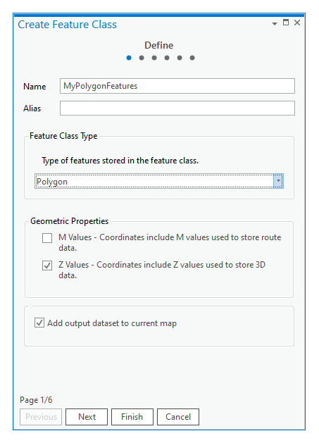

  4. To create a feature class, complete the following steps:
    1. Expand and right-click the database, click New and click Feature Class .
    2. Type the feature class name.
    3. Click the Feature Class Type drop-down arrow and choose the feature geometry you are creating.
      Create Feature Class
    4. Click Next and add fields for the attributes you want to record with each feature.
    5. Click Next and choose a coordinate system.
    6. Click Finish.
      The new feature class is automatically added as a layer to the map and contains no features until you create them.

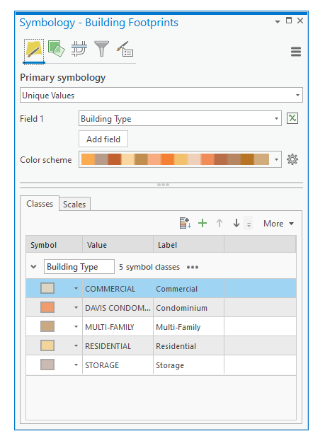

Symbolize the layer
Symbolizing a feature layer configures it to draw features using a specific symbol. Creating a new feature class and adding it to a map automatically generates a default symbol. The symbol also appears in the Create Features pane for templates that create features on the layer.
  1. On the View tab, in the Windows group, click Contents .
  2. In the Contents pane, click a layer.
  3. To open the Symbology pane and change the symbology, right-click the layer and click Symbology .
    Tip:
    This command is also available on the Appearance tab.
    Symbology

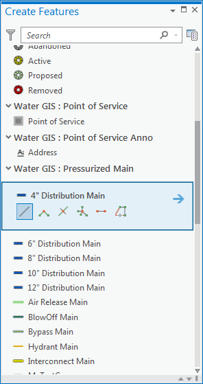

In the Create Features pane, editing templates contain the primary tools with which you create features. Adding a feature layer to a map automatically generates an editing template with default settings. Clicking a template shows its tool palette.
  1. On the Edit tab, choose your snapping preferences, and show the Create Features pane.
    1. In the Snapping group, click the Snapping drop-down menu and enable your snapping preferences.
    2. In the Features group, click Create .
      Tip:
      To open all panes related to editing, on the View tab, in the Windows group, click Pane Sets , and choose Editing.
  2. In the Create Features pane , click an editing template.
    Note:
    Warning icons appear with templates that create nonvisible features for reasons that include mismatched scale range settings, missing symbology attribute values, a failed definition query, and so on.

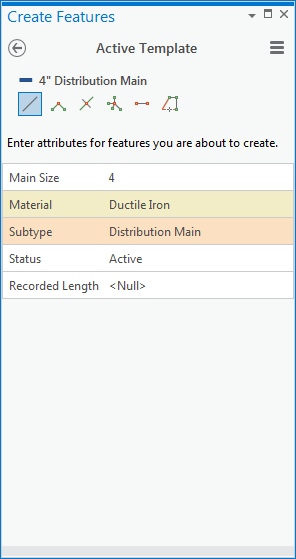

  3. Click the Active template button and type the attributes values you want to apply to the feature.
    Tip:
    To save the attribute values with the template and reuse them the next time you use the template, click the menu button , and click Properties .
    Active Template
