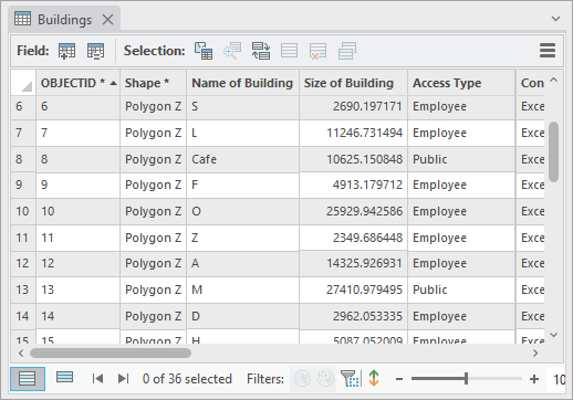

The image below shows the attribute table for the Buildings layer. Each row in the table represents a building on the Esri campus, and all buildings share a set of common fields. In this example, each building has common fields for name, size, access type, and so on.
The attribute table for the Buildings layer

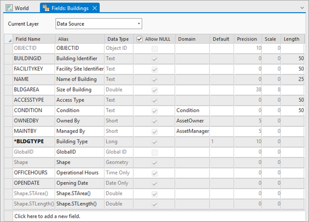

Below you can see the fields view for the Buildings layer. The fields view lists the fields from that layer and has columns to display the properties of those fields.
Fields view for the Buildings layer
