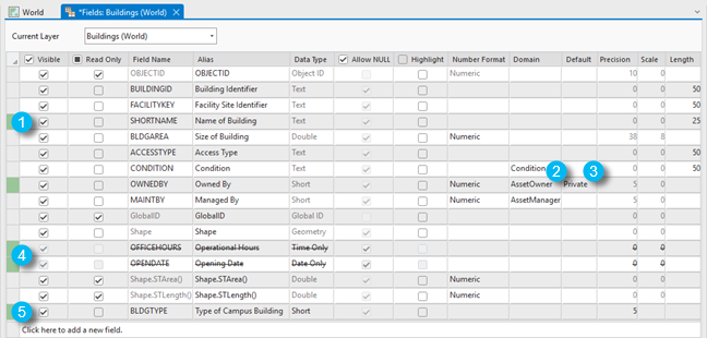

Description
Change the name and alias of a field.
Apply a domain to a field.
Apply a default value to a field.
Delete unnecessary fields.
5
Add a new field named BLDGTYPE to store the type of campus building.
Descriptions of the editing examples performed in the Fields view
Example edits in Fields view
These are examples of edits performed on a layer named Buildings in the Fields view.

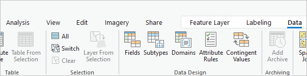

To open the fields view for a feature layer from the Contents pane, complete the following steps:
  1. To open the fields view for a feature layer, highlight the layer whose fields you want to view in the Contents pane.
    This displays the Feature Layer tab set.
  2. On the Data tab, find the Data Design group containing the Fields, Subtypes, and Domains buttons to work with a data model.
    Fields, Subtypes, and Domains buttons on the Data tab
  3. Click the Fields button to open the fields view, which displays the layer's fields in a tabular arrangement.
Fields tab
The Fields contextual tab becomes available when you are in an active fields view.
