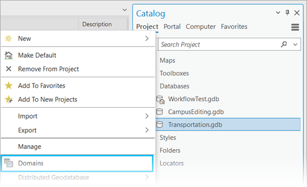

  • Catalog pane—Right-click a geodatabase and click Domains, or right-click the feature class or table and choose Data Design > Domains. When choosing a feature class or table, note that the Domains view displays all of the domains associated with the geodatabase in which that feature class or table is stored.
    Context menu options for the geodatabase

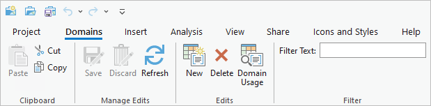

Domains tab
The contextual Domains tab becomes available when you are in an active domains view.
Domains view contextual tab
Clipboard group
Command
Description
Copy
The Copy command adds one or more domains or domain values to the clipboard.
Cut
The Cut command removes one or more domains or domain values from the origin geodatabase and adds the information to the clipboard.
Paste
The Paste command takes the information in the clipboard whether that be one or more domains or domains values and adds the information to the destination geodatabase.
Commands in the Clipboard group
Manage Edits group
Command
Description
Save
The Save command saves all pending edits in the active domains view.
Discard
The Discard command discards all pending edits in the active domains view.
Refresh
The Refresh command refreshes the active domains view with the current state of the workspace.
Commands in the Manage Edits group
Edits group
Command
Description
New
The New command adds a new domain to the domains view.
Delete
The Delete command deletes one or more domains or domain values based on the active selection.
Domain Usage
The Domain Usage command launches the Domain Usage pane.
Commands in the Edits group
Filter group
Command
Description
Filter Text
The Filter Text box allows you to search domain properties that meet your filter conditions.
Tool in the Filter group

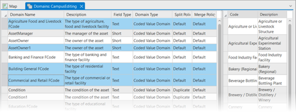

  2. From the origin geodatabase, select one or more domains that you want to copy.
    One or more domains are selected.
    Multiple domains selected in Domains view
    Multiple domains are shown selected in the Domains view by holding the Ctrl key.
