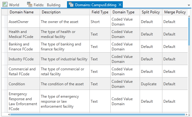

Domains are created and edited within their own tabular-style view called the Domains view. Within the Domains view, you can view existing domains, edit their properties and values, and create domains.
In the image below, you can see the Domains view displaying some of the domains associated with the Campus Editing data model.
Domains view
Each row in the view is an existing domain and they all share common properties such as a name, description, field type, domain type, and split and merge policies.
You can filter the domains listed in the view using the Filter Text text box on the Domains tab available with the Domains view. As you enter text, the view updates with only those domains that have matching text in the Domains view fields.

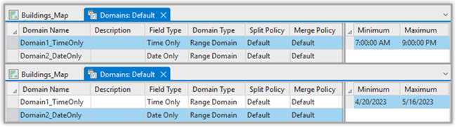

  • Range Domains—A range domain specifies a valid range of values for a numeric or date attribute data type. When creating a range domain, you provide a minimum and maximum valid value. You can apply a range domain to short integer, long integer, big integer, float, double, date, date-only and time-only field types.
    For example, in a feature class for water mains, you can have subtypes for transmission, distribution, and bypass water mains. Distribution water mains can have a pressure between 50 and 75 psi. For a distribution water main object to be valid, its pressure value must be a value between 50 and 75 psi.
    The following example shows two range domains.
    • Domain1_TimeOnly—A range domain created for a Time Only field type, where any time value between 7:00:00 AM - 9:00:00 PM would be valid.
    • Domain2_DateOnly—A range domain created for a Date Only field type, where any date values between 4/20/2023 - 5/16/2023 would be valid.
      Examples of two range domains, 1 on a Time Only field and 1 on a Date Only field

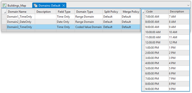

  • Coded Value Domains—A coded value domain can apply to any attribute data type, be it text, numeric, date, and so forth. Coded value domains specify a valid set of values for an attribute.
    For example, water mains may be buried under different types of surfaces, as signified by a GroundSurfaceType attribute field: pavement, gravel, sand, or none (for exposed water mains). The coded value domain includes both the actual value that is stored in the database (for example, 1 for pavement) and a more user-friendly description of what that value means. Coded value domains only allow users to select from a set list of values, so they cannot select any other values during configuration.
    The following example shows a coded value domain.
    • Domain3_TimeOnly—A coded value domain created for a Time Only field. Once this domain is applied to a Time Only field, only these hours appear in the list for a user to select and would be valid.
      Examples of two range domains, 1 on a Time only field and 1 on a Date only field
