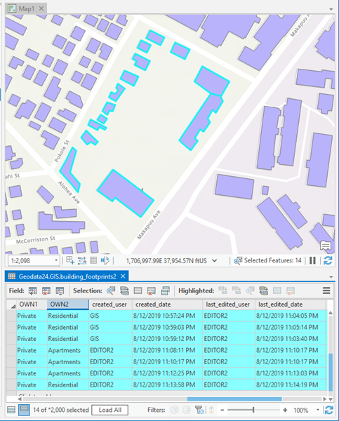

Editor tracking can help answer questions such as who was responsible for edits made within a geodatabase. When editor tracking is enabled on a feature class or table, the following information is tracked automatically:
  • User who created a feature
  • Date and time the feature was created
  • User who last edited a feature
  • Date and time the feature was last edited

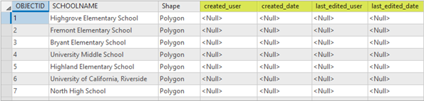

Features that existed when editor tracking was enabled display a <NULL> value for the designated editor tracking fields. The fields that track the user who created the data and the date when the feature was created will remain <NULL>.

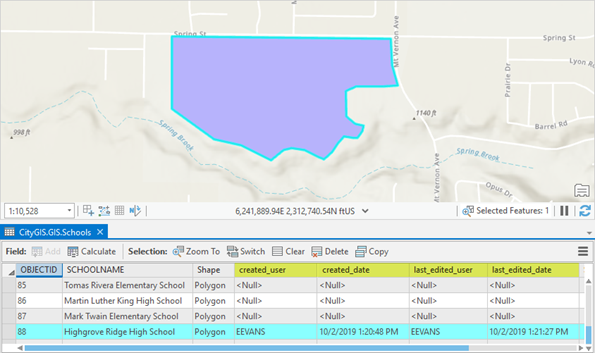

For example, editor tracking has been enabled on a feature class named Schools. The editor tracking fields are highlighted in yellow in the image below.
Four fields are added when editor tracking is enabled using predefined settings on a feature class named Schools.
Editor tracking has recorded the date and time at which the OS-authenticated user EEVANS added a school named Highgrove Ridge High School.
Information recorded in the editor tracking fields when a feature is added

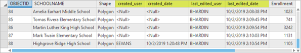

Later that day, another user, BHARDIN, updated the enrollment numbers for the current school year. Editor tracking recorded BHARDIN as the last user to edit this data as well as the date and time the edits were made.
Information recorded in the editor tracking fields when existing features are updated

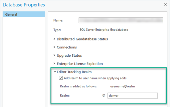

If your data resides in an enterprise geodatabase and you use database authentication, you can append a realm (for example, @esri.com) to the name of the user who makes the edit. For example, if you have a user named John in your Denver office and a user named John in your Seattle office, you can track their edits as John@denver and John@seattle, respectively, so that you can be certain which John made each edit.
To set the realm for an enterprise geodatabase, you must have geodatabase administrator privileges. In the Catalog pane, right-click the connection to the geodatabase, click Properties, and click the Editor Tracking Realm drop-down arrow. You can choose whether to use the default realm or apply your own. You can also append a realm to edits made through a feature service.
Editor Tracking Realm options in Database Properties

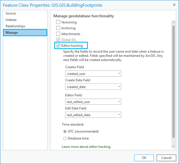

Editor tracking properties are accessible from the Manage tab on the table or feature class properties. To view from the Catalog pane, right-click the dataset and click Manage. Here you can view the editor tracking properties and enable or disable editor tracking.
When you enable editor tracking, you can use default or custom field name values. When enabling editor tracking, any fields specified that do not already exist will be created automatically. If fields do exist, they must be of the correct ArcGIS field data type. Learn more about editor tracking customized field settings.
Editor tracking option accessible from the Manage tab on the feature class properties
The Editor tracking option allows you to set the following properties:
  • Use the Editor tracking check box to enable or disable editor tracking.
  • Choose the fields to update when a feature or record is created:
    • Creator Field—The default value for this field is created_user and stores the name of the user who creates features or records.
      Create Date Field—The default value for this field is created_date and stores the date and time a feature or record was created.
  • Choose the fields to update when a feature or record is edited:
    • Editor Field—The default value for this field is last_edited_user and stores the name of the user who last edited a feature or record.
      Edit Date Field—The default value for this field is last_edited_date and stores the date a feature or record was last edited.
  • Choose the time standard:
    • UTC (recommended)—When editor tracking is enabled on a dataset using predefined settings, the date and time recorded when either the feature or record is created or updated is set to record in UTC by default.
      Database time—To enable editor tracking to record time in database time, use the dataset’s Properties dialog box or the Enable Editor Tracking geoprocessing tool. Recording the time in the database’s time zone is recommended only if users are certain all edits are to be performed in the same time zone.
See Enable editor tracking for more information about the methods available to enable or disable editor tracking.
