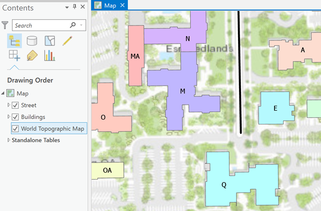

In the following screenshot, a few layers from the Campus Editing data model have been added to a map.
Map of Esri campus
Each of these layers contains a number of fields that describe the properties or attributes of that layer. For example, the Buildings layer represents a collection of campus buildings, and the layer has fields to describe each of the building's properties, such as the name of the building, the type of building it is, the size of the building, and so on. All of this information is stored as fields in a table, the most fundamental of building blocks.

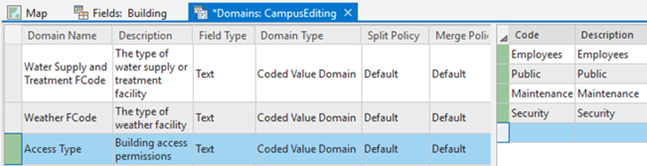

Domains allow you to model specific values to be used on the fields in your layers. They offer a way to enforce data integrity in your data model by restricting the input on any particular field to a list or range of valid values. By creating a domain and applying it to a field, you are limiting the choice of values available for that field. This decreases the possibility of entering invalid information while editing, therefore increasing the integrity of your data model overall.
The following screenshot shows the creation of a new domain called Access Type. This domain is used to determine the type of access permissions an employee needs to enter any given building on campus. This domain is given four valid values: Employees, Public, Maintenance, and Security.
Creating a new domain in the Domains view
Learn more about attribute domains
