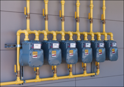

  • A gas utility company tracks inspection reports and safety documents for its pipeline network. Applying a full-text index to the text fields of a geodatabase containing inspection reports, safety descriptions, and maintenance logs allows full-text searches to support queries on phrases for terms such as gas leak or pipeline corrosion, improving the speed and accuracy of safety checks and maintenance planning.
    Gas utility pipeline network

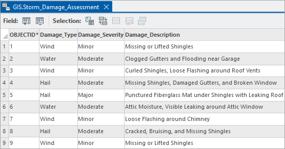

The GIS.Storm_Damage_Assessment table contains several attribute fields that detail the type, severity, and description of damages reported by building owners after recent storms. Additional fields, not visible in this table, include the address and contact information for the owners.
The GIS.Storm_Damage_Assessment table before a full-text index is applied
As the insurance agent for these building owners, setting up a full-text index on the Damage _Description field will allow you to quickly search for keys terms such as Gutters, Shingles, Window, Roof, or Leaks, so that you can recommend the most appropriate contractor for the building owner to contact based on the specific damage and repair work needed.

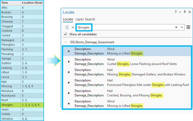

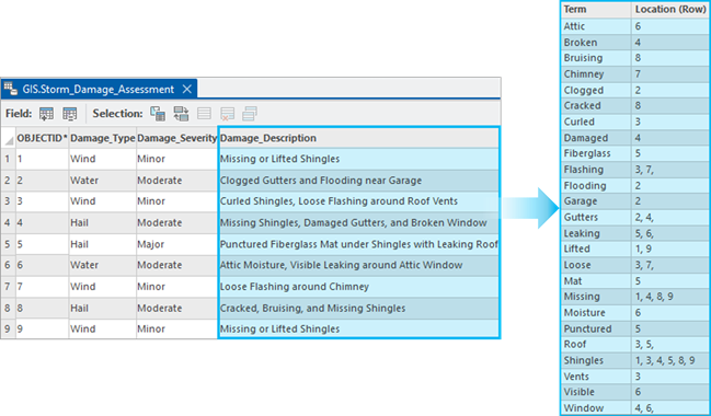

    The following illustration simulates at a high and simplified level, how a full-text index is broken down into individual key terms and how their locations are mapped back to the text field.
    In this example, from the GIS.Storm_Damage_Assessment table, the first attribute value in row 1 under the Damage_Description field reads, Missing or Lifted Shingles. As a simulation of how this full-text index would be populated, this text would be broken down into the following key terms, organized alphabetically, and the exact location where each term appears in the designated Damage_Description text field is recorded.
    • Missing—Appears 4 times, in rows 1, 4, 8, and 9
    • Lifted—Appears twice, in rows 1 and 9
    • Shingles—Appears 6 times, in rows 1, 3, 4, 5, 8, and 9
    Full-text index
    The index acts as a glossary for all the key terms in the indexed field, organizing and tracking the exact location where each word appears back to the original index.
    This process would continue until all the text in the designated text field has been broken down into key terms, organized, and the location recorded where each term appears.
  3. Once the creation of the full-text index on the Damage_Description field has completed, you can use the Locate pane to apply the full-text search mode Full Text Equals, to the Damage_Description field.
    From the Locate pane, set the Full Text Equals as the search mode for the field containing the full-text index
  4. For this example, from the Locate pane, you can search for the word Shingles
    Without a full-text index applied, the search would result in a more time-consuming full-table scan. However, since a full-text index was created on the Damage_Description field, from the Locate pane, you can query this field for a single word, Shingles. The Locate pane uses a full-text search to quickly identify the term Shingles and locates all the rows where that key term appears in the indexed field, similar to the following.
    Query results on a full-text indexed field
    The results from your search will allow you to quickly identify any damage reports that involved roof shingles so the building owner can contact the most appropriate contractor based on the specific damage reported.

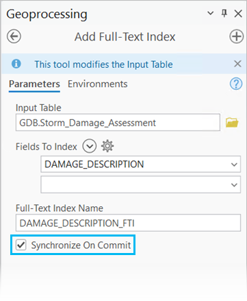

    • Synchronize On Commit is an optional parameter that is only available when using the Add Full-Text Index tool on a table or feature class in an enterprise geodatabase in Oracle. Synchronize On Commit can be used to specify whether a full-text index will be updated automatically when edits are saved or an ArcGIS sync operation is performed.
      Synchronize On Commit parameter on the Add Full-Text Index tool

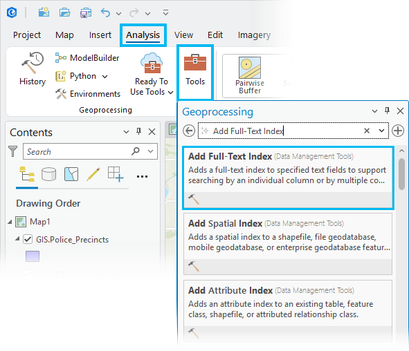

  1. Open the Add Full-Text Index geoprocessing tool by navigating to the Analysis tab and clicking Tools in the Geoprocessing group. Alternatively, you can search for the tool in the Data Management Tools toolset in the Indexes toolbox.
    Add Full-Text Index tool under the Analysis tab, Tools, and Geoprocessing

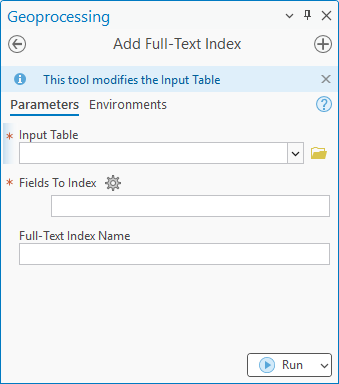

    The Add Full-Text Index geoprocessing tool dialog box appears with default settings.

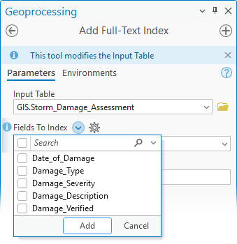

  3. For Fields To Index, select either a single field or multiple fields that will have a full-text index applied.
    Fields To Index parameter
    Note:
    Some databases only support a single field for full-text index creation. Support for creation of a multiple-field full-text index varies based on the database.

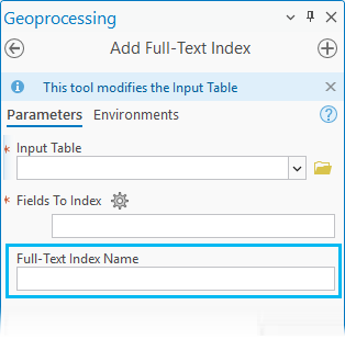

  4. Optionally, the name of this parameter will change depending on the source for your Input Table.
    • Full-Text Index Name—Provide a name for the index that will be created. The Full-Text Index Name parameter appears by default.
      Note:
      For SQL Server, SQLite, and mobile geodatabases, the Full-Text Index Name parameter will be ignored.

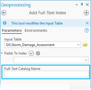

    • Full-Text Catalog Name—Select the name of the SQL Server full-text catalog you want to use for the Full-Text Catalog Name parameter. The Full-Text Catalog Name option is only applicable for SQL Server.
      Note:
      If the Full-Text Catalog Name is not provided, the tool will attempt to use the default full-text catalog defined for the database if it is accessible. Otherwise, select a full-text catalog from the drop-down list. The drop-down list includes all the full-text catalogs that the connected user is able to access.

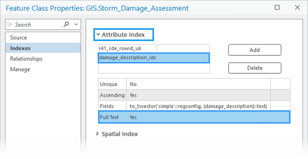

Once the Add Full-Text Index tool completes, open the properties dialog box of your table or feature class. Under the Indexes tab, the Attribute Index section displays the existing indexes for this dataset. Select the newly created index and the Full Text parameter below will display Yes to indicate this is a full-text index.
Indexes tab on Feature class properties dialog box
