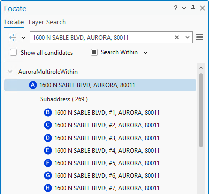

  2. Enable the feature type collection in the Search Within control you want returned by the locator.
    Checking the box in the Search Within control enables all feature type collections and returned in the order listed.
    1. Click the Search Within drop-down arrow and choose the collection or collections to return.
      Available feature type options in the Search Within control
      • POI—Return all features of type POI that are associated with a geocoded PointAddress or PostalExt address type candidate.
      • Point Address—Return all features of type PointAddress that are associated with a geocoded PostalExt address type candidate.
      • Subaddress—Return all features of type Subaddress that are associated with a geocoded PointAddress or PostalExt address type candidate.
      Note:
      Using the Search Within control overrides the Return associated features setting in the locator or locator view properties.
      The order in which the checkboxes are enabled determines the order in which the collection of features is returned in the Locate pane. Enabling the Search Within control enables all feature types in the order in which they are listed in the control.
      The Search Within functionality is currently not available for composite geocode services.
  3. In the Locate pane, in the Search text box, type the address or postal code you want to find and view the associated features.
    As you type, suggestions appear in a drop-down menu based on your input. The suggestions are generated by locators based on the settings you chose on the Provider Settings view accessed from the Options button on the Locate tab in the Locate pane. You can press Enter to search based on text you enter in the search box, or you can click one of the suggestions to perform a search based on that text.
    Note:
    The Locate pane displays search suggestions generated from the ArcGIS World Geocoding Service, as well as custom-built locators used locally or published as services.
    If the address is matched, the address candidates appear in a list under the locator that returned them, and as labeled points on your map. The matched input address is listed first, followed by a feature type header showing the number of associated features. Below the header is the list of features related to the input address.
    Subaddress count and result using Search Within control

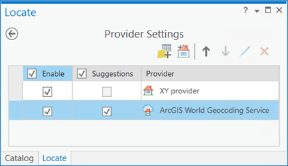

    1. Click the Options button and click Provider Settings.
      The Locate pane displays a list of available locate providers. There is also a list of locators that includes those that were added automatically from your portal connection as well as those you added manually.
      Settings tab of Locate pane
      Note:

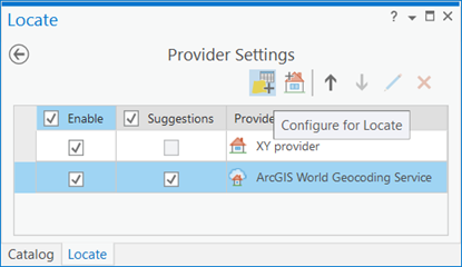

      Layers or tables that you add to the map do not appear automatically in the Locate pane. You must configure them for search first.
    2. Click the Configure for Locate button to add a layer or table from your map to the Locate pane.
      Add layer or table to the Locate pane.
      The Select Layer or Table dialog box appears, listing all the layers or tables that are available in the Contents pane.
      Note:
      Tables without ObjectIDs, such as text files (.txt and .csv, for example) cannot be configured as locate providers.
    3. Select a layer or table from the list on the Select Layer or Table dialog box and click OK.

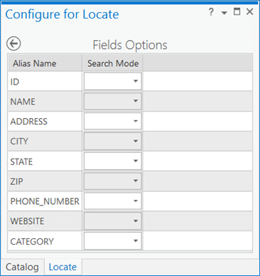

    4. For any field that you want to search against, choose Full Text Equals, which allows you to perform case insensitive, full text searches; Full Text Starts With, which allows you to perform case insensitive, full text prefix searches; Equals, which allows you to perform exact searches; Starts With, which allows you to perform case sensitive search of only the beginning part of the field; or Contains, which allows you to perform an approximate search.
      Note:
      The full text search modes allow you to perform faster searches that reduces the amount of resources used by the database and server for feature services. Full text indexes can be added to fields in a table or layer stored in a mobile geodatabase or in an Enterprise geodatabase by your database administrator or by using the Add Full-Text Index tool. The Full Text Equals and Full Text Starts With search modes are available if the table or layer exists in a mobile or an Enterprise geodatabase and a full text index exists for the field.
      Note:
      If the layer or table to be configured contains fields that have an attribute index, which improves search performance, those fields are automatically configured with Equals as the Search Mode option. If the layer or table to be configured is stored in a mobile or an Enterprise geodatabase and contains fields that have full text indexes, those fields are automatically configured for search with Full Text Equals as the Search Mode option.

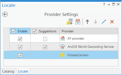

    5. Click the Save and return to Provider Settings button at the top of the pane to save your search configuration.
      A message appears indicating that the fields you configured for search should be indexed. Indexing improves performance and is helpful if your dataset is large and you'll be searching it frequently.
      The Locate pane displays the Provider Settings view, and your newly configured layer or table is displayed in the Provider Settings list. You can change the order of locate providers in the list, which determines the order in which a search is performed as well as the order in which results are returned and displayed in the Locate pane.
      Settings tab of Locate pane with layer added
    6. Click the Back to Locate pane button at the top of the pane to go back to the Locate tab.
