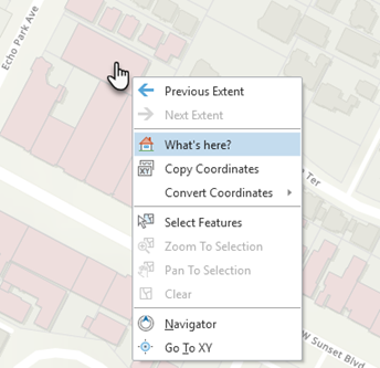

  1. Pan or zoom on the map to a location where you want to identify an address or place, and right-click a location on the map. Select What's here? from the context menu that appears.
    Selecting the What's here? tool

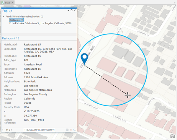

    A pop-up appears that displays the information for the addresses, places, or intersections closest to the location that you right-clicked.
    What's here? tool pop-up result and click location with crosshairs and pin for matched location
    If more than one result is returned, you can click the arrows at the bottom of the pop-up to browse the results.

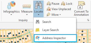

  1. On the Map tab, in the Inquiry group, click the Locate drop-down menu.
  2. Click Address Inspector.

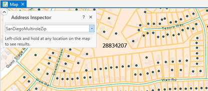

    The Address Locator tool overlay window appears in the upper left of the view.
    Address Inspector tool overlay window open in the Map view
  3. From the locator selection drop-down menu, choose the locator you want to use to identify locations on the map.
    Locators added to the project that support reverse geocoding automatically display on the Address Inspector overlay window locator drop-down menu.

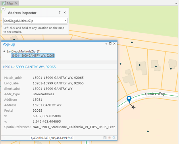

  5. Click any location on the map.
    A pop-up appears that displays the information for the address or place closest to the location that you clicked. Crosshairs showing where you clicked and a pin showing the location it matched are also displayed on the screen.
    Address Inspector pop-up, crosshairs, and location of match result
    Tip:
    Double-click the location on the map to keep the pop-up displayed. This allows you to copy any details about the location before identifying more locations.
