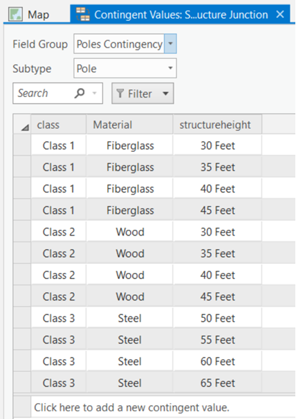

For the pole example above, in a field group named Poles Contingency, the set of contingent values are as follows:
Contingent values for the Pole example
