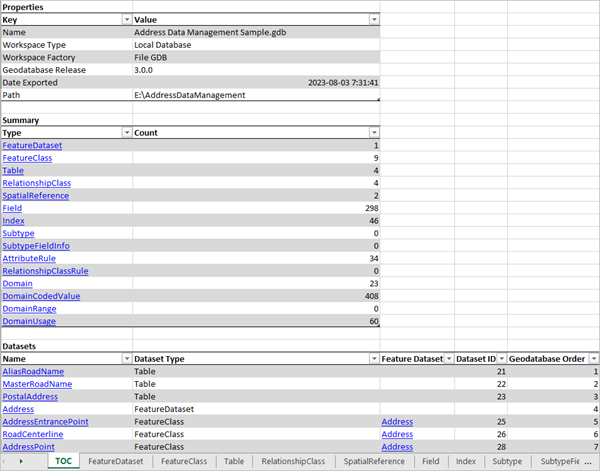

Excel
The following is an example of an Excel workbook generated from address data in a geodatabase. The table of contents (TOC) tab provides an overview of the information included in the report. To quickly navigate to other sections of the workbook, you can click the hyperlinked text or use the worksheet tabs along the bottom.
Example Excel report output from the Generate Schema Report geoprocessing tool

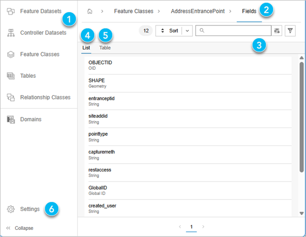

The following table correlates the numbers in the image above from the list view with its corresponding element number and description.
Element
Description
The navigation bar displays geodatabase objects like datasets and geodatabase functionality such as domains.
The breadcrumb trail indicates the relationship between the hierarchy of the schema report and the information displayed in the content view (table or list view).
Sort, search, and filter tools allow you to locate information quickly and efficiently.
List view displays information in the content view to quickly scan.
5
Table view displays information in the content view so you can see all of the common properties.
6
Settings control the display of system properties throughout the entire report.
Elements from the schema report list view

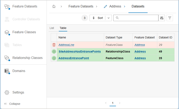

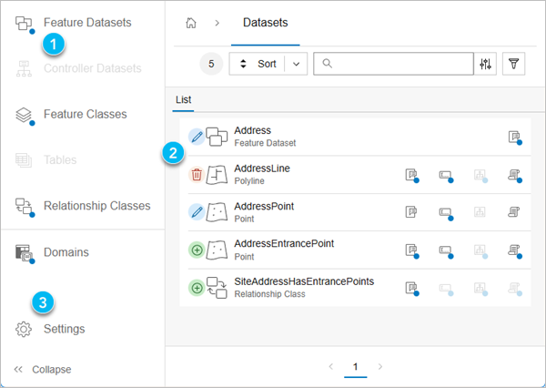

The schema comparison report is created using the compare schemas geoprocessing tool and has the same look and feel as the Dynamic HTML report output with a few noticeable changes. By default Show Differences Only is turned on. An example of the list view of the schema comparison report is listed below:
List view of the compare schema report output from the Compare Schema geoprocessing tool
Element
Description
Blue dots indicate differences in the report.
Insert, update, and delete icons indicate the type of change. Updates may comprise an insert, update, and delete depending on the hierarchy level in the content view.
Settings control the display of system properties and visualizing differences only.
Elements from the schema report table view.
An example of the table view of the schema comparison report is listed below:
Table view of the compare schema report output from the Compare Schema geoprocessing tool

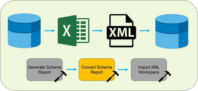

Make schema changes in the schema report
A common workflow is to export the schema report to an Excel workbook and then perform schema changes within Excel. This offers an alternative to opening up and working in multiple Design views (Fields, Domains, Subtypes, and so on) to make schema changes and can often times be a faster and more productive workflow when mass schema changes are needed.
The short video below offers a quick overview of the workflow.
The following steps outline the workflow and geoprocessing tools used, which can be applied to any number of data modeling tasks.
  1. Generate a schema report and export it to an .xlsx or .json file.
  2. Open the Excel workbook or JSON document and make schema changes.
  3. Convert the schema report from its original format to an .xml file.
  4. Create a geodatabase from the Catalog pane, a catalog view, or a geoprocessing tool.
  5. Import the XML workspace document containing the schema changes to the new geodatabase.
Diagram for generating a schema report, converting it to XML, and importing the XML document to a new geodatabase
For more information on making changes in the schema report, read the Edit schema reports for conversion blog article.
