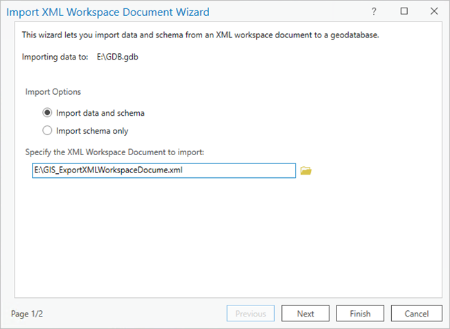

To import an XML Workspace Document using the Import XML Workspace Document Wizard, complete the following steps:
  1. In the Catalog pane, right-click a geodatabase. Select XML Workspace Document within Import from the context menu.
    The Import XML Workspace Document Wizard pane displays.
    Import XML Workspace Document page 1 of 2

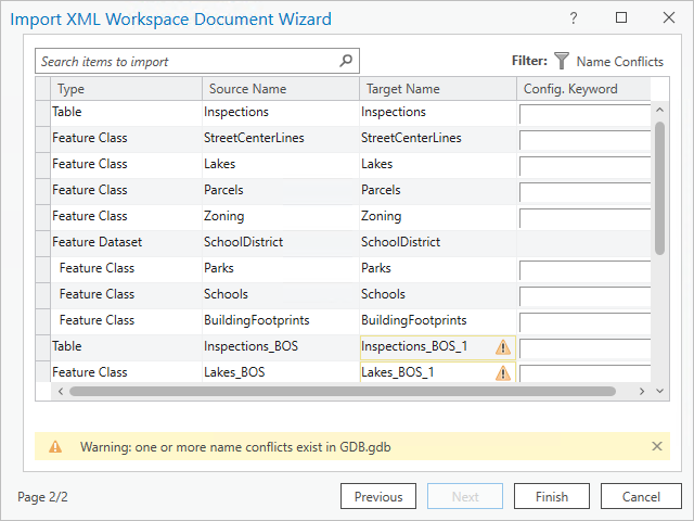

  2. For Import Options, choose Import data and schema or Import schema only and specify the XML Workspace Document to import and click Next to view the list of datasets and any potential conflicts before importing.
  3. Review the list of datasets, feature datasets, and domains. Optionally, modify the name and any configuration keywords prior to importing into the geodatabase.
    Note:
    To list only the items that have a name conflict, click Name Conflicts.
  4. Click Finish to import the XML workspace document.
