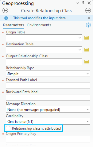

Although not as useful as it is with many-to-many relationships, when you're setting up a one-to-one or one-to-many relationship, you may have the same need to store additional attributes in an intermediate table. If this is the case, you must specify this by checking the box next to the Relationship class is attributed option on the Create Relationship Class tool when you create the relationship so an intermediate table is created for you.
Relationship class is attributed check box on the Create Relationship Class geoprocessing tool
As with many-to-many relationships, the intermediate table of an attributed relationship class maps primary key values from the origin to foreign key values from the destination, allowing you to store any number of attributes for each relation.
