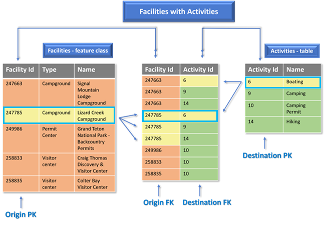

Many-to-many relationships require the use of an intermediate table which can store attributes for the relationship itself.
A many-to-many (M:N) cardinality diagram between a Facilities feature class and an Activities table shows that a facility can host multiple activities, and an activity can be performed in more than one facility.

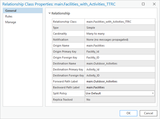

  2. Optionally, right-click the relationship class in the Catalog pane and click Properties.
    You can manage relationship class properties from the General, Rules, and Manage tabs.
    Relationship Class Properties dialog box
    Tip:
    The geodatabase functionality listed under the Manage tab on the Relationship Class Properties dialog box is enabled, as these are the properties of an attributed relationship class.

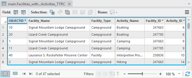

    For example, if a relationship class is created with the Table To Relationship Class tool, which requires an existing table populated with additional attributes about the relationship, the resulting intermediate table could look similar to the following. In this example, the intermediate table for this attributed relationship class contains all the valid relationships between the Facilities feature class and the Outdoor activities table, where the Facility_ID field is the origin foreign key and the Activity_ID field is the destination foreign key.
    The fields and attributes populated in an intermediate table of an attributed relationship class created using the Table To Relationship Class tool

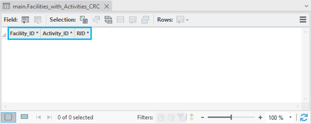

    If a relationship class is created with the Create Relationship Class tool, the intermediate table will only contain the required fields, and the values within these fields must be populated, as ArcGIS does not map the associations between origin and destination objects. Using this tool to create an attributed relationship class means the intermediate table must be populated manually, and the resulting intermediate table could look similar to the following.
    Only the required field names appear in an intermediate table of an attributed relationship class created using the Create Relationship Class tool.

You can use the Attributes pane to add relationships between two objects. In a many-to-many or attributed relationship class, the intermediate table maps and stores associations between the origin and destination objects. When a relationship is created between two objects in this type of relationship class, a new row is added to that intermediate table. This row is populated with the values from the primary keys in the origin and destination objects.

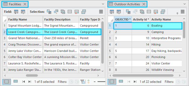

  2. Use the Select tool to select related origin and destination objects interactively. If a table participates in the relationship, select Open to open the table from the Contents pane and select the desired rows.
    For example, using the image at the top of this topic, the Lizard Creek Campground in the Facilities feature class must be associated with the Boating activity in the Outdoor Activities table. The Lizard Creek Campground (origin feature object) and the Boating (destination feature object) have been selected.
    Selected related objects

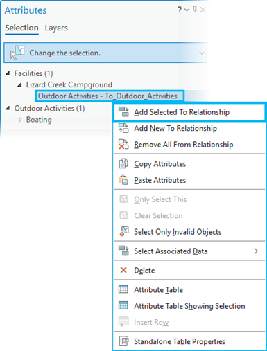

  4. Click to expand the selected origin feature in the Attributes pane and right-click the relationship class label.
  5. Click the Add Selected To Relationship option.
    Lizard Creek Campground in the Facilities feature class has been associated with the Boating activity in the Outdoor Activities table.
