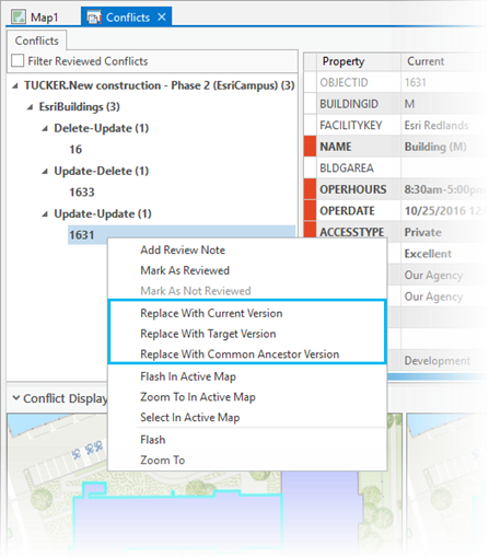

In branch versioning, conflicts can be discovered during the reconcile process when the named version is reconciled with the default version. For example, a conflict will occur when a topologically related feature or relationship class is modified in both the current named version and the default version.
Tip:
Review the named and default versions' editing conflicts using the Conflicts view.
Conflicts context menu for branch versioning
In branch versioning, when you resolve conflicts, you are deciding which representation of the features and attributes you want to keep. Deleting a feature from an origin relationship class may trigger a message to delete a feature from the destination relationship class. Therefore, be aware of the ramifications of replacing conflicts involving source feature classes participating in relationship classes.
Learn more about resolving conflicts with relationship classes using branch versioning

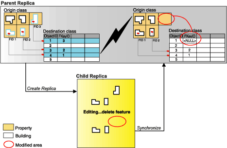

Geodatabase replication allows you to replicate some or all datasets in an enterprise geodatabase. It allows you to define which features or rows to replicate using filters and relationship classes. During replica creation, rows and features are added to a replica based on the filters defined in the application. Then, relationship classes are used to append additional features and rows.
The following example illustrates the replication behavior concerning related objects. The data model used in this example is a simple origin-destination relationship between properties, buildings, and their related annotation.
Related objects with replication
See Prepare data for replication for more information.
Synchronization maintains relationships. For two-way and one-way replication, the same filters and relationship class rules used in replica creation are applied during synchronization. All edits in each replica dataset applied since the last synchronization are evaluated when determining the changes to send. If an edit satisfies the replica's filters, it is synchronized.
For example, some features in an origin class, such as buildings, were selected for replication. The buildings are related through a simple relationship class to attribute records in a table excluded from the replication. During editing on the child replica, a building was deleted. On synchronization, to void the relationship with the feature that was deleted, the corresponding entry in the foreign key field in the related destination class, the table, is set to NULL.
Replica creation and synchronization process when incorporating related records, from a non-attributed simple relationship class, into a replica
Learn more and see additional examples of synchronizing with filters and related data
