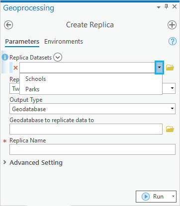

Definition queries are applied to the layers in the map and are not saved with the dataset in the geodatabase. That means that you must either drag the layer from the map Contents pane to the Replica Datasets field in the Create Replica geoprocessing tool, or choose the layers from the Replica Datasets drop-down menu on the Create Replica geoprocessing tool as shown below.
Do not use the browse button to add the replica datasets. Definition queries from data in the map are not honored when the browse button is used.
Create Replica geoprocessing tool displaying the drop-down option to select features in the map with definition queries applied

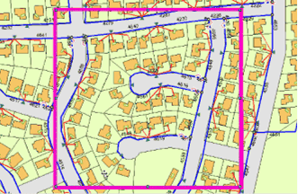

A maintenance crew is preparing to do inspections in a residential area. To do some field editing, the crew needs to replicate that part of the infrastructure that covers this residential area. To start the replication process, the spatial extent of the inspection area is identified using a spatial filter (in this case, the extent is set using the environment setting).
Work area extent

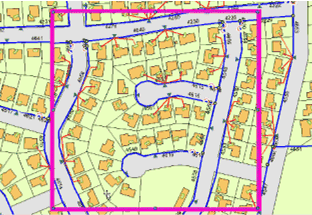

The crew is to concentrate on cables that have been insulated with a particular material. To identify these cables, a query is applied to the relevant dataset.
Definition query applied to features in the work area extent

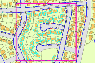

Finally, as each maintenance crew can expect to visit only a certain number of properties in a day, the homes in one residential block are identified by a definition query based on property numbers. This is shown as a selection below.
Selection set of homes impacted by the definition query in the work area
The selected features, features identified by a definition query, and features that intersect the chosen spatial extent will be replicated. Some additional features have also been included.
Data within the extent and definition query to be replicated
